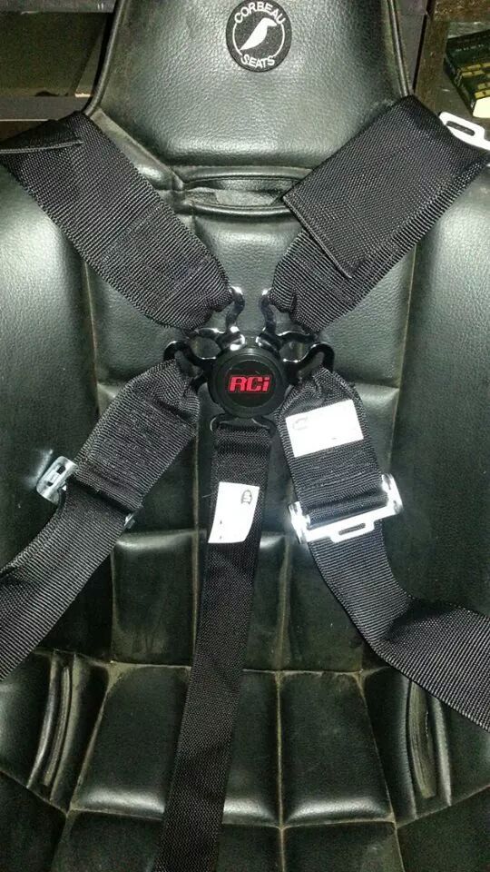

While the block was being checked, I pulled the cab and got to work on it as it was completely stock (unsafe). I ripped out every wire, insulation and plastic piece along with the seat and heater components. I found a pair of Corbeau offroad seats on Craigslist and ordered the correct mounting bracket. I also ordered a pair of racing harnesses and got started of a custom aluminum center console to house the Art Carr shifter, 12 switches, two 12 volt power sources, master cut off switch, starter button and two beer holders. The nitrous bottle mounts in between the passenger seat and console. I took out the heater controls and cut an aluminum panel to hold the Autometer gauges (oil pressure, water temp, trans temp and ammeter). The cab also got an aluminum fat grip steering wheel by Longacre. The rusty floors were repaired and I rolled bed liner in the floor and the back of the cab.
