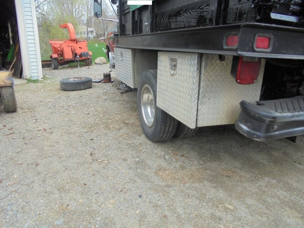

latest update;
quad underbody toolboxes.
just put my final box on last night.just can't seem to ever have enough places for gear and tools.the more boxes,the less unloading/reloading stuff when dumping loads.
the rear boxes.this is interesting;
dee zee makes the front boxes nice and deep.but their shorter boxes are not as deep! that bugged me.i wanted all the depth i could get.then i found a site that has dee zee custom make their boxes.you can see they have 'em put their own logo on 'em.so anyway,i ended up with same nice deep boxes front and rear since i have plenty of room under the 8' wide dump bed.
the rear boxes dump with the bed though,since there isn't any room for brackets.the rear springs are directly in the way.doesn't bother me though.just happy to have more space.
now maybe one of these days,i'll finally ditch that rear bumper for a piece of C-channel or something so it fits the dump bed.
no messing around with mounting them either.i cut up some angle bracket laying around for real support.so no worry about loading 'em up.ok so i did get carried away using grade 8 hardware,but it was cheap insurance.used it with all boxes.

Nice! Like what youve done there..... love that front end!
https://www.ford-trucks.com/forums/a...1&d=1338650921
But thats got to go! Ya need some nice tube bumpers.

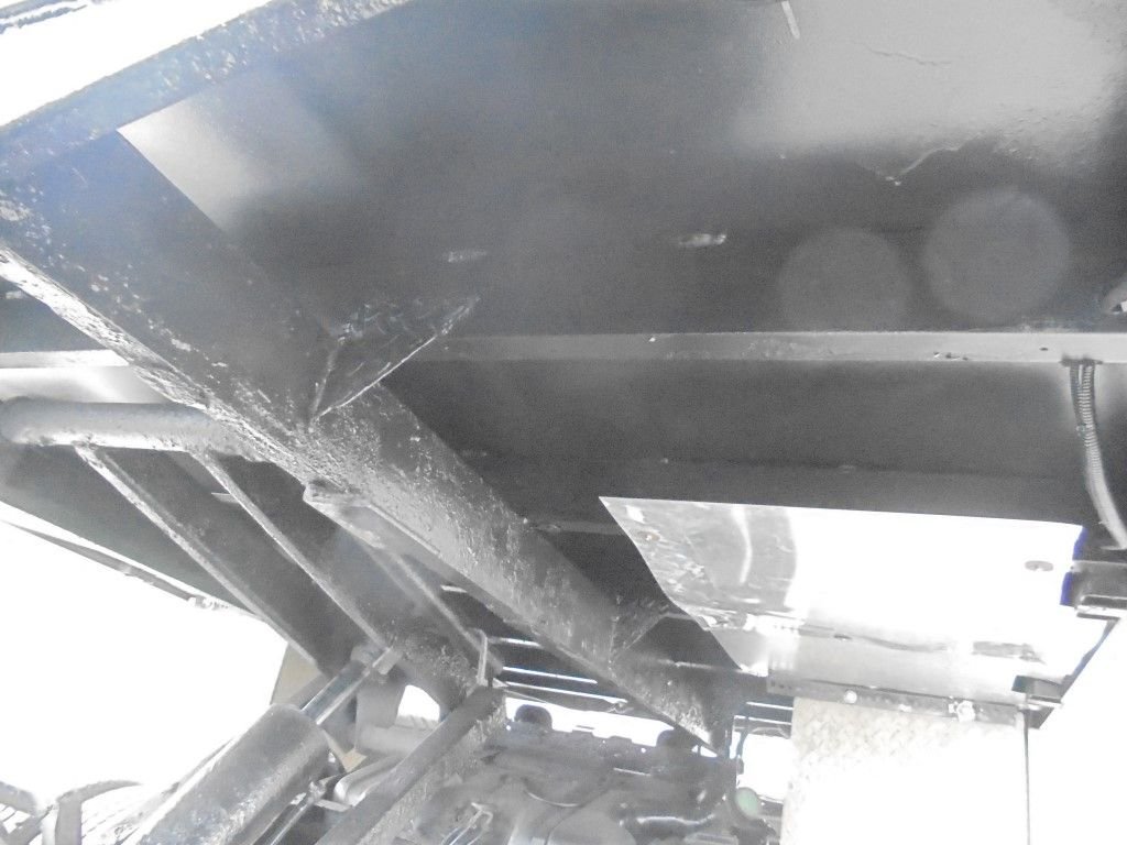

going over her a little bit again to keep her in tip top shape.
Originally Posted by FORDF250HDXLT
well that was effortless.it looked worse than it was.i just picked up the cleaner and prep por stuff and did that last night.i thought about getting a quart so it would be enough to fill up my spray gun one time.im glad i didn't and just got a pint and used a brush to touch up because i only used half a pint.
the bad places that the salt/calcium started eating up after two Maine winters was mostly right around the wheels of course where everything gets flung and sticks in large 6-8" thick chunks at times of course.
the underside of the cab all looks great still.didn't need to touch any of this.
so here it is touched up and im now ready to mask off my dump hoist res and toolboxes and spray on the tri coat etching primer.
looking at that primer can,i see i need to wait 24 hrs for it to dry.holy crap never seen primer take so long.but oh well.no rain tomorrow either so it's all good.
dump bed got a fresh coat of the tractor enamel already as well as the chipper while i had the gun out.
i'll take another snap latter once everything under the dump is all primed for my tractor enamel.then tomorrow i'll put on a crap ton of coats of the tractor enamel and post those pics.i got a whole new gallon as i put on two thick coats on the upper dump and chipper which took a whole gallon.so i can just go crazy if i want and just keep shooting the whole gallon up under here if i see fit cus this is where she takes all the winter abuse.
she's too nice of a truck not to keep up on now.got to keep her solid.paint sure is a lot cheaper than rust repair.

and she's back to looking like she's supposed to under there again.
she took one quart under there today.i used another quart on the half roof and the inside walls of the bed to freshen her all right up.so now iv got a half gallon left.
the paint says to wait 24 hrs between coats.so i'll toss another good coat on tomorrow (3rd quart.) then i'll throw a 3rd coat (last quart) on her Sunday too and use the gallon right up.no such thing as too many coats under the bed and around them wheels where all the road slush/ice packs up in the winter.
should be good for a couple more years again after this.that's the thing,just keep up with it.let that calcium eat some paint instead of metal.if this tractor enamel doesn't hold up good i'll try some marine boat paint next.

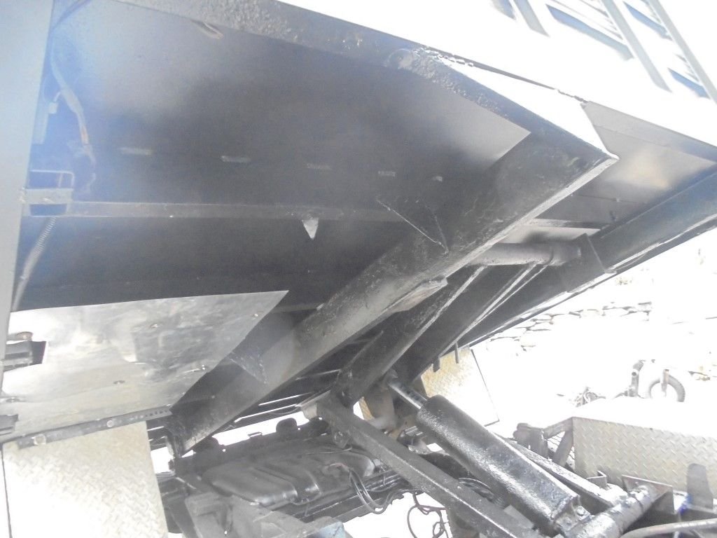

is that the deck Roger? what did that weigh?
my light budget poplar deck is holding up great.i opted to leave it uncured since it's up where it can just dry right out.looks just like it did when i put it down so far.haven't snapped off one bolt either.
here is 2nd top coat that i hit around noon yesterday.just snapped the pics.though it looks wet its just super glossy enamel.she'll dull down soon enough.so a few more hours i'll shoot her final coat on to use up the rest of the paint.then i'll unmask and snap some final pics.last winter i started to lose my aluminumized sheet on one side because i foolishly didn't use fender washers.what was i thinking? silly mistake.so i got some stainless fender washers and started to see if the self tappers would unscrew.i was shocked most did! some broke off of course so i'v got to re drill and self tap like 4-5 of them.nothing too serious.
this is the paint im top coating my por-15 with this time for those curious:
Valspar Tractor & Implement Enamel.
http://www.valsparpaint.com/en/find-...nt-enamel.html
you mix with mineral spirits to brush on,or naptha like im using,to spray it.
iv read (i didn't look) that tractor supply no longer carries it.i picked mine up at car quest.

3 coats on and ready to get dirty working her again tomorrow.

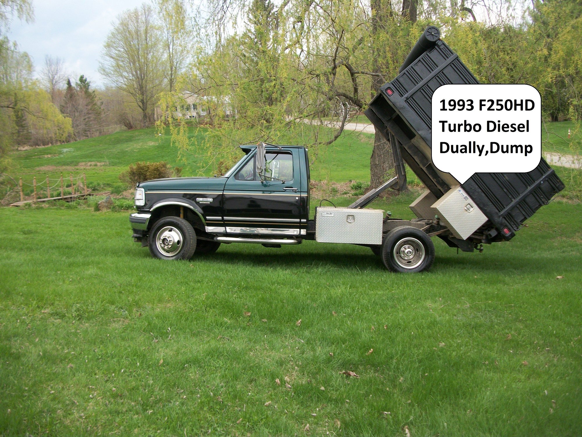

New sides,back and new metal deck put down this winter.
Couple plywood scabs in there.Not quite time to replace them.Can get another season out of them like this.Still look ok from the outside,so.
I think I'm gunna keep eyes open for free/cheap plastic bed liners.Cut out 8' sheets from 3 of those.A font and the 2 sides.Lighter,they wont keep rotten out and I won't need to keep painting them black.I think they'll be just the ticket.
New solid metal deck.Now it's like my F450's.That wood deck lasted all these years though,so hey.Can't complain.This is nicer though for sure.
You can see my frame repair I needed a few years back.They cracked right up here!Welded and fishplated.Stronger than she was now.Been great ever since.She split apart on both sides! I work her like an F450.No fault of the trucks lol.
Notice my aux overload pack? I have these setup to take the load instantly.They hold the truck right here (and help that D50 stay in alignment and not eat tires! Works awesome!) I can toss 2-3 ton on and she just sits there and takes it............However,I suspect this is why it stressed the frame here on both sides of the truck though,but matters not anymore beefed up like this.
Some new thin sheets up over the wheelwells.These are vital for keeping road slush/salt snow from sticking up inside your c-channels and rotten them out,for anyone who runs their rig with the flatbed in the winter.Very helpful!
Yeah,nothing too serious.I'll have her back together after coffee break in no time.Just replacing a front wheel u-joint.Those duralast u-joints I'm finding are holding up just as good as the spicer and moogs I keep replacing in the rear and front drive shafts fyi.Here I am replacing just my second duralast (red rubber seals with the grease fittings) since '09! I can live with that.I do keep her greased up regularly and these don't take the pounding I put on the shafts either so.The other side is fine so I'm running 'er.I've replaced the wheel bearings,(back around '09 too) however I see the axle bearings in the spindle are gone,so I just put a new one in while at it.Re-packed the bearings and about ready to go back together.U-joint and axle is back in.
For the bed,I still need to ditch that rear pickup bumper lol.Replace it with a pipe or two and or just a thick C-channel and paint it black will look good.The rear dump hinge is getting thin on both sides too.Need those replaced before they break off.Likely do this something this season.I think they'll be fine for another year or two but not gunna risk it.I don't want nothing to happen when dumping a load.Get 'em replaced before I risk breaking something worse.Other than that,she's ready for some more work.
Let's see.Mostly old pics in this thread now.A more current one of the truck from a couple years ago.Basically looks the same as this,though with nurf bars gone and replaced with old school running boards.I'll have to update my pics of her.(oh yeah,even this one is still 3 years old this month.)
Man,this old truck sure has been good to me.She still has a lot of life in her too at just around 150k miles or so now.Her cab floor has a few small rust holes and might be getting a bit soft here and there but I bet I've got 5 more years before I even have to have those replaced yet.At some point,I really do need to start thinking about upgrading her to a F450 as well.Starting with another IDI, 9th gen F-Superduty/F450 platform and a proper 4wd convert using more modern F450/550 axles and such.....at some point.This bed will be extended out to 12' at that time and set on the F450.For now,this old gal is still treating me good.As for my current F450/log truck,I really,can't put off body work and paint for that so I'll be updating that truck at some point this summer too with a new paint job.
