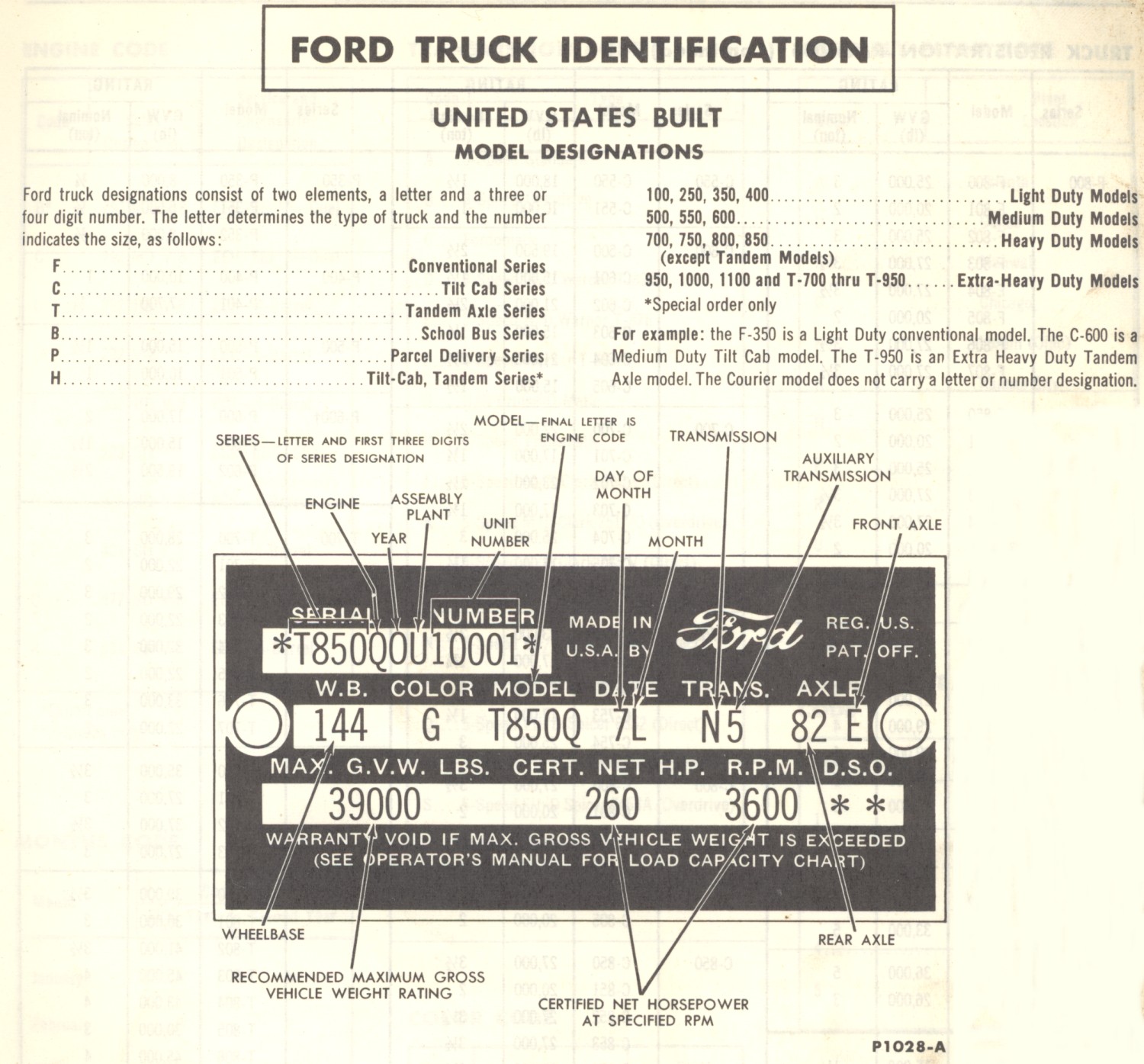

60 F100 data plate
Can anyone give me the info on that?

Maybe this will help:
See the link for further decoding:
1960 Ford Truck VIN
Number Dummy can give you all the specifics, but as the lady pointed out, the link she gave you is a good place to start. First your truck is an F100, came with a 6 cyl, was built in Chicago, Long bed, montecarlo red, built Jan 27th, 3 speed standard with a 3.70 rear end. At least that is what the site breaks it down to. Number Dummy should have further insight. Good luck, sounds like a great truck!

F10J0G16986 / 118 / J / F100 / 27A / A / 01 / 5,000 / 126 / 4,000.
F10 = F100.
J = 223 1V I-6.
0 = 1960.
G = Chicago IL Assembly Plant.
16986 = Numerical Sequence of Assembly.
118" Wheelbase.
J = Red.
F100, 5,000 lbs. GVWR
27A = Assembled January 27, 1960.
A = Ford Light Duty 3 Speed Manual Transmission.
01 = Ford 9" Rear Axle / 3.70-1 / non Limited Slip / 3,300 lb. Rear Axle Capacity.
5,000 lbs. Gross Vehicle Weight Rating.
126 net HP @ 4,000 RPM
