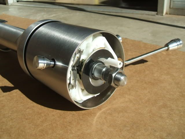

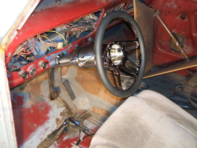

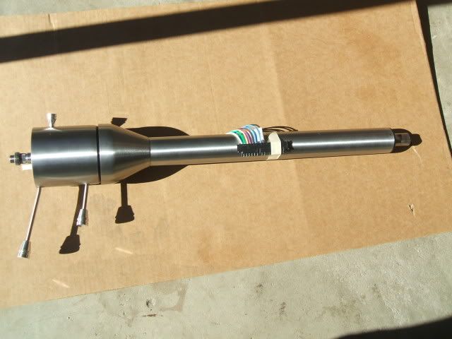

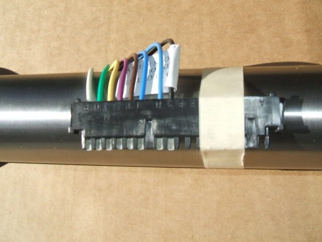

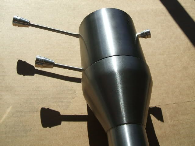

My new steering column and wheel
I just need to finish welding in the lower mount plate and instal the horn button then paint it.

very nice marz , always quality work , would look good cleared also , love the brushed metal look .

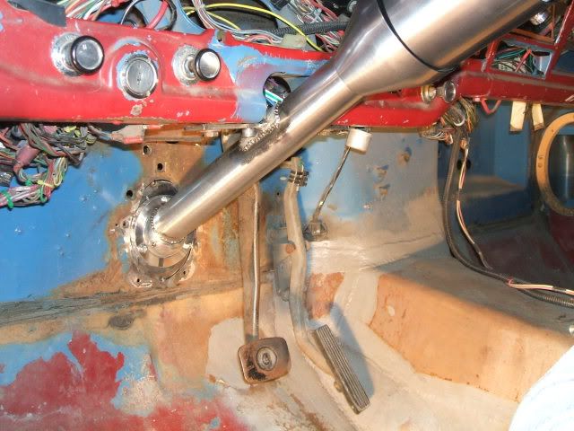

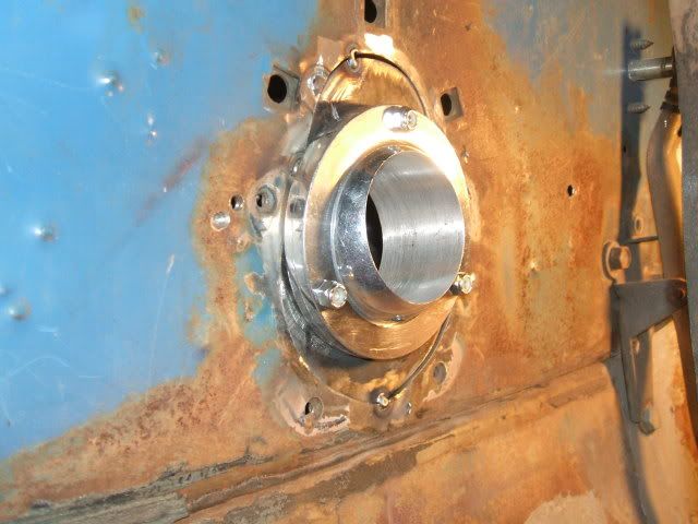

Why weld the column to the socket? That sort of defeats the purpose of the swivel socket.
Ididit makes a tilt specifically for the ford 67 to 72 dash mounts.?

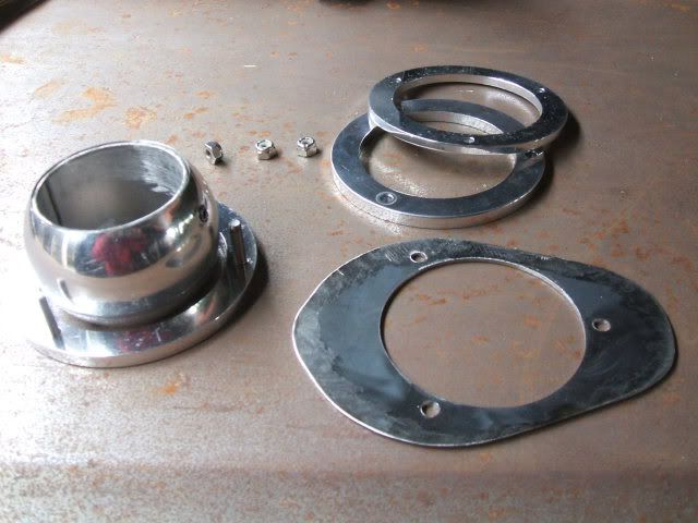

The socket is not welded to the column, I welded a piece of tube to the column cause
the socket has a 2 1/4 opening and the column is 2" round. I did this cause the socket was free so I just had to have it on there one way or another.

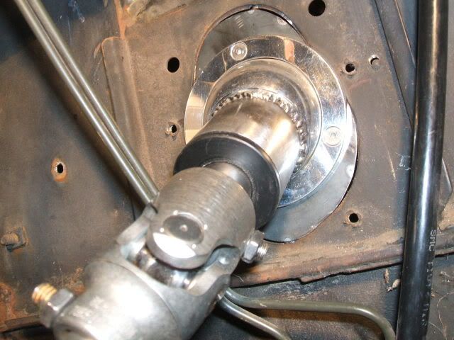

i love mine. only problem is if it starts to squeal you have to push the bottom black plastic seal back in. and i never got around to re-wiring the horn, so if i hit it i get a shock.lol

So the black plastic seal is a dust shield?

Should the column be grounded , the stock coupling or rag joint is grounded from 1 side of rag to the other side on the stock set up , just curious ? With the horn and ts switch you would think you would need a ground strap from the column to the firewall ?

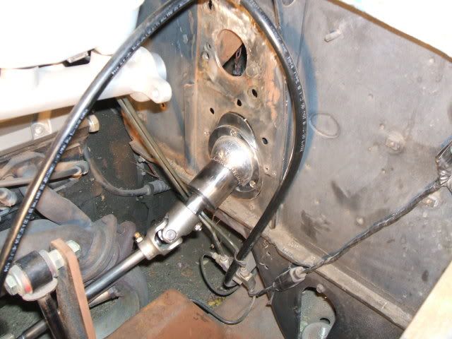

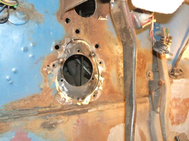

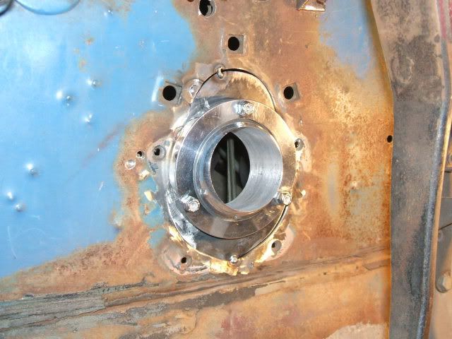

Kewl,
Was wondering when i seen the beads.
Here is my solution to a firewall steering. http://i368.photobucket.com/albums/o...6/PC060324.jpg
And the inside.
http://i368.photobucket.com/albums/o...6/PC060321.jpg
Garbz

Ken, Grounding is important for horn function, so I vote yes.

garbz2,
I was in such a hury to get this thing mounted before the rain comes that i decided to do it this way but I really would have preferd to have done it like the pictures you posted. oh well!! it's all good!

Is there a socket made for to fit that column. I have the same one sitting in the garage. I also have the 94 Stang joint for the Panther front suspension, the DD shaft, and column cupler. I wasnt sure how I was going to get it mounted through the fire wall and this is the answer!! Looks like I can have a clean install after all!!

Marz, looks kewl to me brother.....the sleeve thing works... I assume it was layin around.
I did mine with spare crap laying around. I wanted a stock column and wheel for the build, but people to look three times before they realize that it is a 65 to 72 column in there in a 63....I did some custom dash rework to get it all to work.
Keep up the good work and see you at the Western Nats in June.
Garbz

my truck has been rewired and has a 5 pin relay for the horn, the column came with a 3pin on that needs to be used. the column is grounded to the dash, but i still need to swap the relay over.
