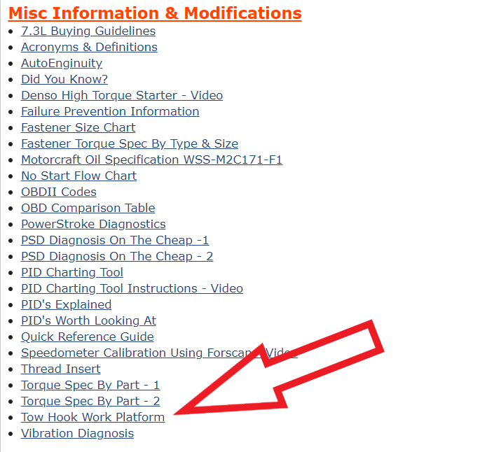

Just in case anyone would like to build one of these in the future, the link to this thread was already in the 7.3L PSD Tech Folder and will remain there until the end of the internet.

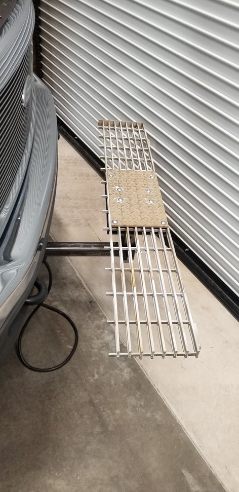

Front Receiver Hitch version
For those of us with a front receiver hitch, I finished my receiver hitch mount work platform today (except for paint). As some of you may remember a number of years back I built a top side creeper for the receiver hitch, which works great but it is heavy and not so portable, and sometimes a platform across the whole front end is what you need. I built it all from free stuff I had laying around, some left over aluminum drain grate, some 3/16" plate, 1/4" diamond plate aluminum and some receiver tube. Even the bolts were free, I have a surplus of 3/8" carriage bolts that come with a part we use all the time at work but we never need the carriage bolts. I wanted something height adjustable and also be able to bring it out away from the truck if needed for laying way over the engine without crunching your knees into the grill. I made it secure by tapping some holes in the tubing for bolts to secure it from rocking. It weighs 38 lbs all together and knocks down for storage or travel in 30 seconds or so. It has about 10" of height adjustment in 2" increments and 18" of in-out adjustment by sliding it in and out of the receiver tube then tightening the bolt. First pic is lowered all the way, 2nd is up all the way and slid out. I will be packing it along when we go to Mexico in April.
