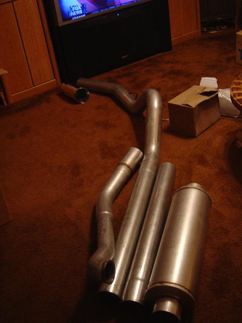

Here's my cut up stock DP, the stock DP next to my first 3in DP, and finally my aFe 4in exhaust kit with a DP that starts out 3in, then goes to 3.5, then 4in. I straight piped the whole exhaust. No muff or kitty. You have to agree a round DP is way better than the stock one. If you still have your cat you may want to think about gutting or removing it too. All they do is collect soot and restrict flow.
