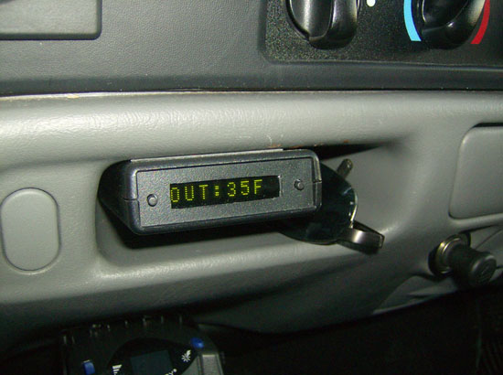

I've used the 16F877A quite a bit both at work and for home stuff.
My F250 didn't have an outdoor temp display so I rigged one up with a PIC and a sensirion temp/RH sensor. The button on the left allows me to toggle between outdoor temp, outdoor RH, indoor temp, indoor RH, and battery voltage. I never look at anything besides outdoor temp but its still cool I have it set to warn me if the battery drops low.
The button on the right allows me to change between three brightness levels.
