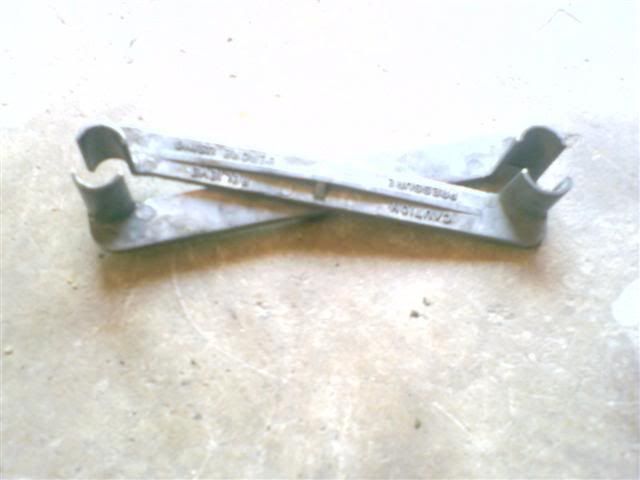

It's not that hard. Get a floor jack and a piece of plywood about as wide an long as the tank. Unbolt the straps and lower the tank enough to unhook the quick connect fittings, and it's out. You'll need the tool to unhook those fittings. Don't get plastic either, they'll break. Been there, done that.

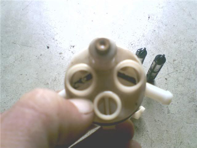

I would look at some possible other solutions to your problem before dropping the tank. Like the ICP for example. Got some Pro's on FTE that could save you and offer advise on what to check .
I'm not saying your issue is related to the clogged screens in your tank, but if your dropping the tank i would do the tank mod for sure, per guzzle...
Just cleaning the screens? I guess that would work for a quick cheap fix.
If you insist on using the original setup i would go get a couple new replacement screens.
It is a pretty fine mesh and probably a pain to just clean.
How about just taking the screens out and tossing in the trash. Use the housing without the screens?

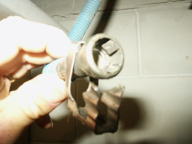

Here is a pic of mine. Not to bad. When i did my dads, his was just about clogged solid and his motor ran ok.
Screens in the tank
Fuel connection x 2 and tool needed.
