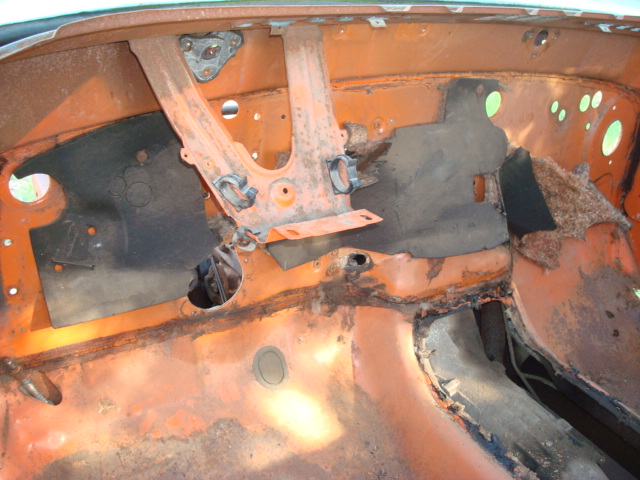

Also, in answer to your question, yes the windshield wipers come through the cowl. The wiper mechanism is inside the cab. There are two gaskets that seal the linkage. If you need them, LMC and Dennis Carpenter have them.
Here are some pictures of the mechanism and holes, not very "detailed" though.

I'm thinking wiper holes!!!!!!!the position looks perfect. I haven't gotten under there to look. but last time I was under the dash I didn't notice any problems. With the condition of the rest of this truck I hope there are no rust issues....
thanks for the picture. I'm going to put a windshield in it since it picked up a chip. so I'll start there.
