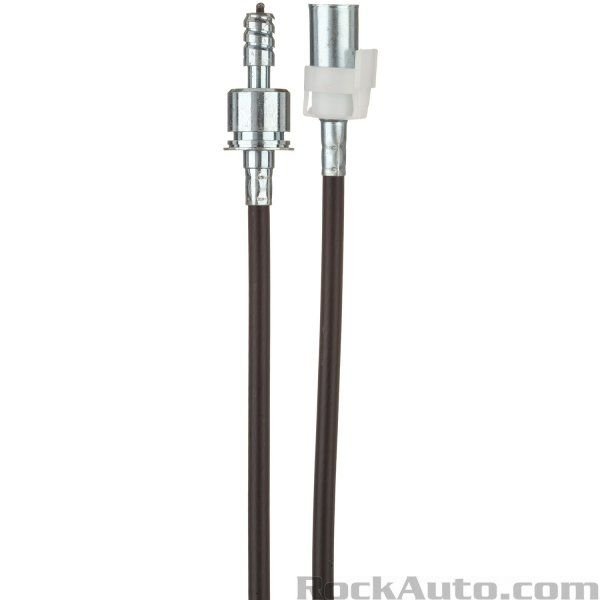

Yup that is a speed sensor used with EFI or cruise control in pre EFI applications.. Now the question is will your cable plug in to it ? The vehicles that used these the cable just plugs in and looks like this.

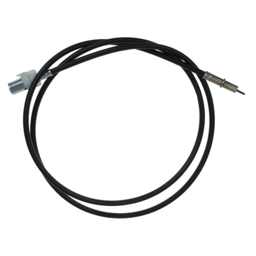

I believe this is the guy you need .
https://shop.broncograveyard.com/86-...uctinfo/31685/
This is a one piece cable I think the stock ones in your truck are 2 piece. This will make it a once piece cable as the later trucks used up until they quit using speedometer cables.
Do away with your 2 Piece cable and get a one piece one.
You will have to remove yours and measure it. I'm pretty sure you will have to pull the gauge cluster to get at the connector at the back.
Rock Auto has a good selection speedo cables They are under interior parts. Check different year trucks up in to the 90's to find what you need the lengths are listed. You want Cruise Control application cables.
Below are pics of the cable ends W/Cruise and W/O Cruise
The Cruise cable end just plugs in to the speed sensor. No tools needed. Same for removal it just pulls out.
With Out Cruise Control
With Cruise Control
