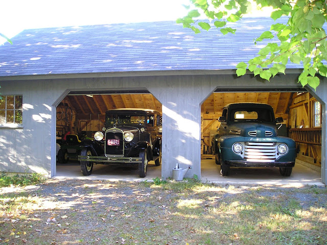

I like the idea of the ceiling hung unit but I think should wait until I have a ceiling and insulation. Right now I've got an uninsulated building open to the rafters with a peak about 15' above the floor. In the spring I may put plywood across the joists to enclose the area a bit and insulate the walls. It sounds like once the space is closed up and insulated the heater needs to be externally vented. In the mean time, I'll probably get a cheap convection heater that runs on propane and set it in the middle of the floor. Home Depot has one for around $100. There's enough air coming through the walls so I won't run out of oxygen and it should be able to take the chill off. Attached is a picture before I closed up for the winter.
