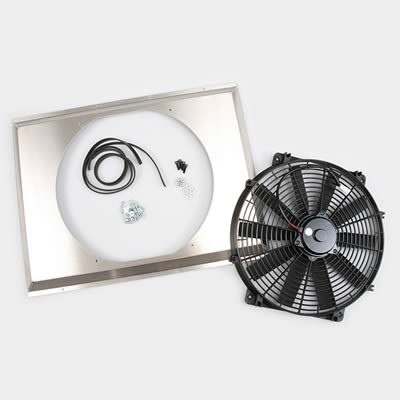

Just a bit of info, even an e-fan will need a shroud for the purpose of making it draw from the entire radiator. They are shallow and can even be made from baking sheets if you so desire. I've seen where adding a simple baking sheet shroud will increase the efectiveness of an E-fan by about half or more.
George

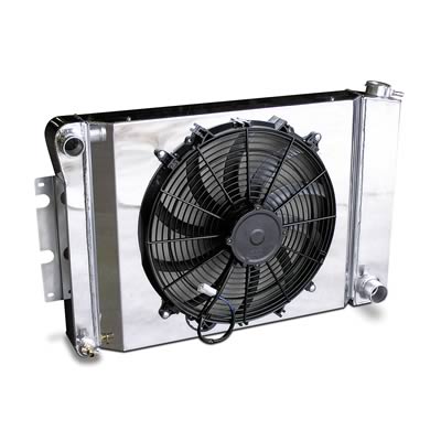

Here is what a shroud looks like on an E-fan. You can see how easy it is to make one from a baking sheet, just get an aluminum baking sheet, cut your holes and viola! Cheap fan shroud. If you need help making one I'll be more than happy to write up a how to.
George
