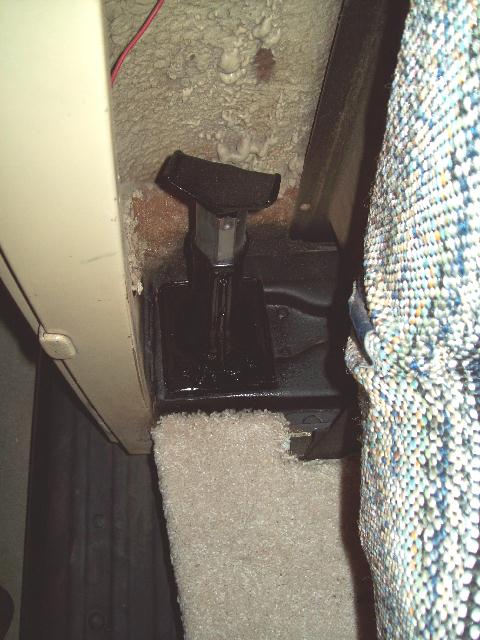

On the Bonus Built, the jack was stowed on the floor behind the seat on th epassenger side of the gas tank. Since your gas tank is under your drivers side running board, there's a difference of course. Look for a hole with a nut in it in the back right corner of the cab - just as a starting place.
51 Jack location:
Name:  F Original Jack  2 Restored.jpg
I'd check out the car parts swap meets for one. DON'T get suckered into buying one off E-bay. They sell for up to $100 and I saw 3 or 4 at the last 3-day parts swap meet for under $15!
