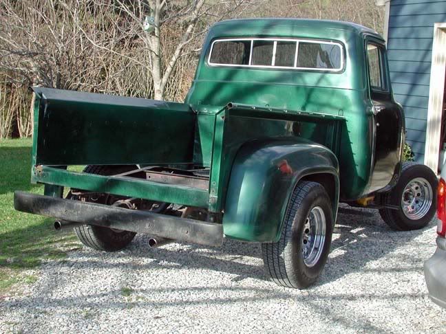

It's been about 15 years ago since I did it, but I remember it was an easy job. I don't remember the diameter of the rope but I believe it was 3/16";enough to be able to pull the rubber gasket over the inner flange of the cab window frame. I placed the new window/frame in he gasket and installed as a unit. I did not use the window sealer.
Here is a picture of my "old"/sold '56 in VA:
