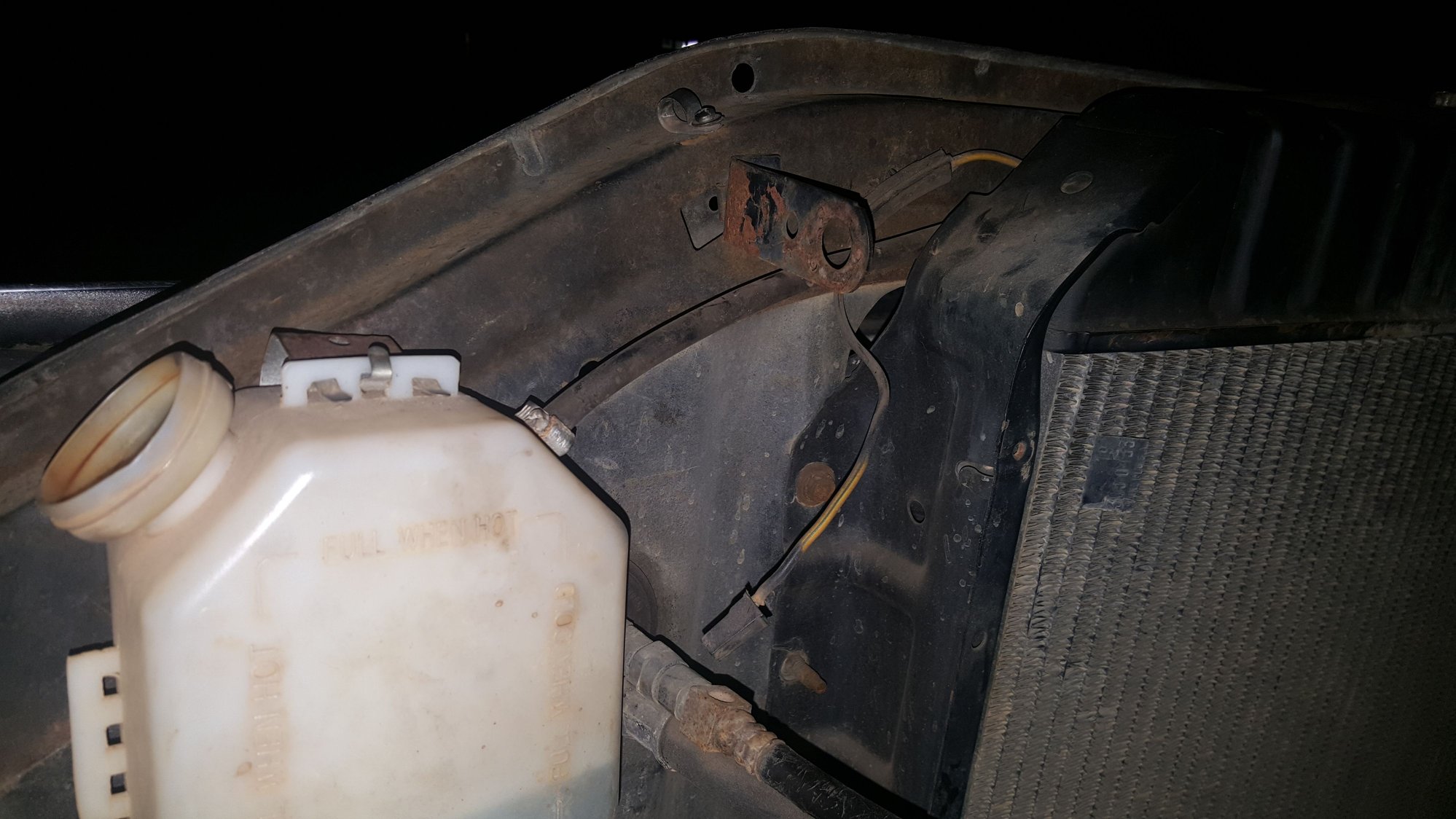

I will tomorrow. I am missing a cap from my bottle. I just purchased this truck and am new to these forums.

No such thing was available factory installed until 1980 excepting 1973/74 F100 240 I-6 2WD & M/T.
Basic part number is 8A080, here's the page (upper) from the parts catalog. 8522 is the basic number for the dealer installed kit (lower pic).
1979 f150 ranger lariat trailer special
Can you confirm that's factory installed? Or is it an add-on?
Old Mar 9, 2016 | 01:15 AM
  #29
Ronnief150man's Avatar
Ronnief150man
Joined: Feb 2016
Posts: 299
The truck is not currently with me but once it is I will look at bracket. I know it's not just sitting there. It is attached to the front end frame.
