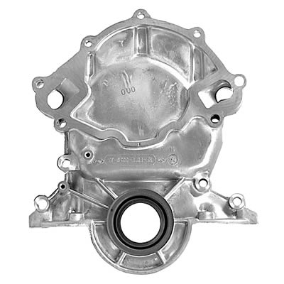

What you're going to have to do is determine if the pump you have is turning the correct way for your belt setup. If it isn't then you have a choice..
A) change the belt setup to turn the other way which may mean changing the pump pulley to a flat from ribbed or vise versa and may require a different length belt.
B) change the pump and timing cover for the other rotation or maybe use a universal pump.... these have round holes in the back cover versus the D shaped holes.
If it is turning the right way then you must have an obstruction in the coolant system somewhere.

I pulled the pump last night to check it and you are correct that it is reverse flow. I had thought about trying to reroute a longer belt to change the rotation of the pump but then that would change the rotation of the fan to blow air forward and not into the engine compartment wouldn't it? I guess I will have to try and find a timing cover and pump that will fit but I'm not sure what to look for. Guess I'm kinda stuck for now.

Yes, there is a date code as well as the casting number on the cylinder block above the starter motor, cleverly placed there so that the starter motor need be removed to read it (unless you are lucky and handy with an inspection mirror).
However, if the engine has been rebuilt or parts swapped around this might not be conclusive. The timing cover is the important part for the water pump to match. Can you get a casting number off of it?

After looking at the pictures and diagrams of the FlowKooler pumps that Beanscoot posted the pump that I have looks exactly like the 1660 reverse flow from the rear and just like the 1653 from the front. The belt path that I have is also like the reverse flow in the FlowKooler diagram next to the 1660 pump. The impeller in my pump resembles that of the fan on an alternator with the blades facing the same direction – from the top angling toward the right as it comes down to the center (I don’t know how better to describe it). The timing cover is the exact same as the one on the right in the post from Conanski, and the casting number is RF-F6TE-6059-JB. The d-shaped holes in the pump and timing cover also match up perfectly. So with all of this I am assuming that I have the right pump for the timing cover and should not be experiencing problems.
You will have to excuse my ignorance but as I stated this is the first Ford that I have ever really worked on and I am still in the learning process. When I tried to buy a pump for an ’82 in Arizona the only ones at the two Autozone stores I went to resembled the cast iron FlowKooler 1650 pump and they did not show anything shaped like the 1653, that is when they found the one for the ’90 that I have now. This weekend I did a search at both Checker and Autozone online here in Colorado and both of them show a pump available for an ’82 that is just like the one that I have now, so I guess I should have searched while I was in Arizona and pursued it more. Either way it appears that the pump that I have should be working, or am I missing something again? If this setup should be working correctly where do I go from here?
