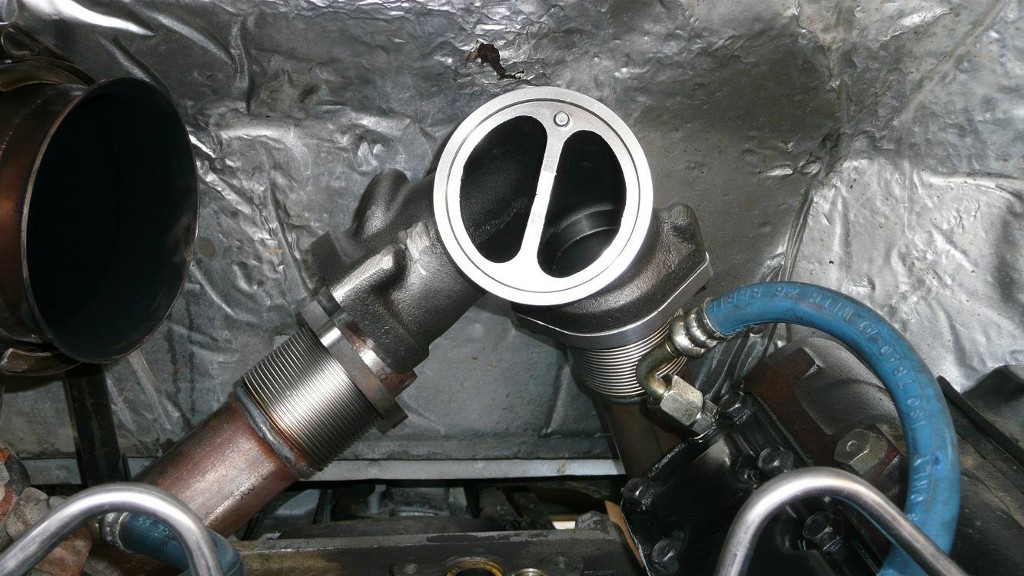

This past weekend we pulled my turbo and installed a WW. We also deleted the EBPV. We removed the plunger, and plugged the hole. The "flapper" was welded in the open position. The sensor is unplugged from the pedistal base as well.
Since this I have had issues with low boost, I did find one IC boot loose and took care of that. My EGT's are much higher than before when i romp on it. It seemed to be ok today coming back from NC for a bit but then started climbing after a bit. I let the truck cool down and then took it for a ride. I had it in 120 hoping to blow the boot off that is causing the problem. I hit 15 psi and my EGT's were at 1600* (Honestly) I let off as soon as I saw the guage sweep tht far. This was all within a few seconds.
I made up a leak detector and will check that tommorow, I also checked the upipes and they care clean as a whistle. Any other ideas as to what else to check where as my brain is like jello due to sleep deprivation.

Dont know if its possible Jim but could the flap have came loose restricting the flow and cause this?

I checked that first and the weld is still there. Roland welded the arm of the actuator to the body of the exhast housing so that should be all set there

How about the clamp from spider to turbo, turbo and BB clamp?? Thats all I can think of Jim, my BB clamp was loose a bit, went back and tightened everything up after my switchout.

If you didn't state that the butterfly valve was welded in the open position, I would say the EBPV is stuck closed.

Throwing this out there, wastegate opening up too soon and too far? I think the BB clamp is either off or on from what I saw.

I think the turbine inlet dowel in the seperator of the up pipe collector didnt seat into the turbine housing where the dowel goes. Did you line the collector to the back of the turbine, clamp it snug before seating it down on the pedestal? The up pipes will always look clean here. I drove to BTS and to smokin 07 like this and man did i get some chitty mileage.

The butterfly was welded in the open postion Dan. Roland checked that.
That is exactly how we did the up pipe collector Kris. I actually took a white rag and wiped around the up pipes to check for soot. My mileage was really good though.
Everything looks to be ok The truck runs great until I romp it just the low boost and when I romp it hight EGT's
If the waste gate opens to soon will that cause the hight EGT's maybe I have two issues a boost leak and someting else.

Jim, I just did this same upgrade to my turbo about last weekend and it was a bit... by myself! But I ( instead of leaving the butterfly in there I drilled out the two spot welds on the butterfly and pulled the entire valve out of the turbo and then nickel plate welded the hole full)remember this is cast and maybe you have some cracks in your turbo now do to the heat generated from a wirefeed or a stick weld? just trying to give you a theory also I have zero restrictions now because my valve is completly removed! also double check that pain in the @#@ Band clamp in the back, maybe you don't have it in the notch correctly but I doubt that because there was no room for erorr when I done mine! good luck
