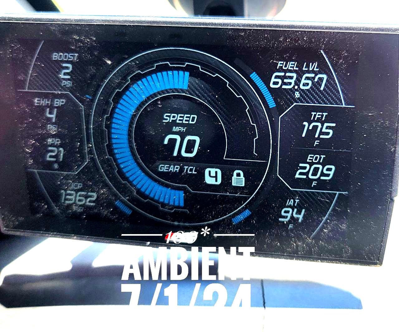

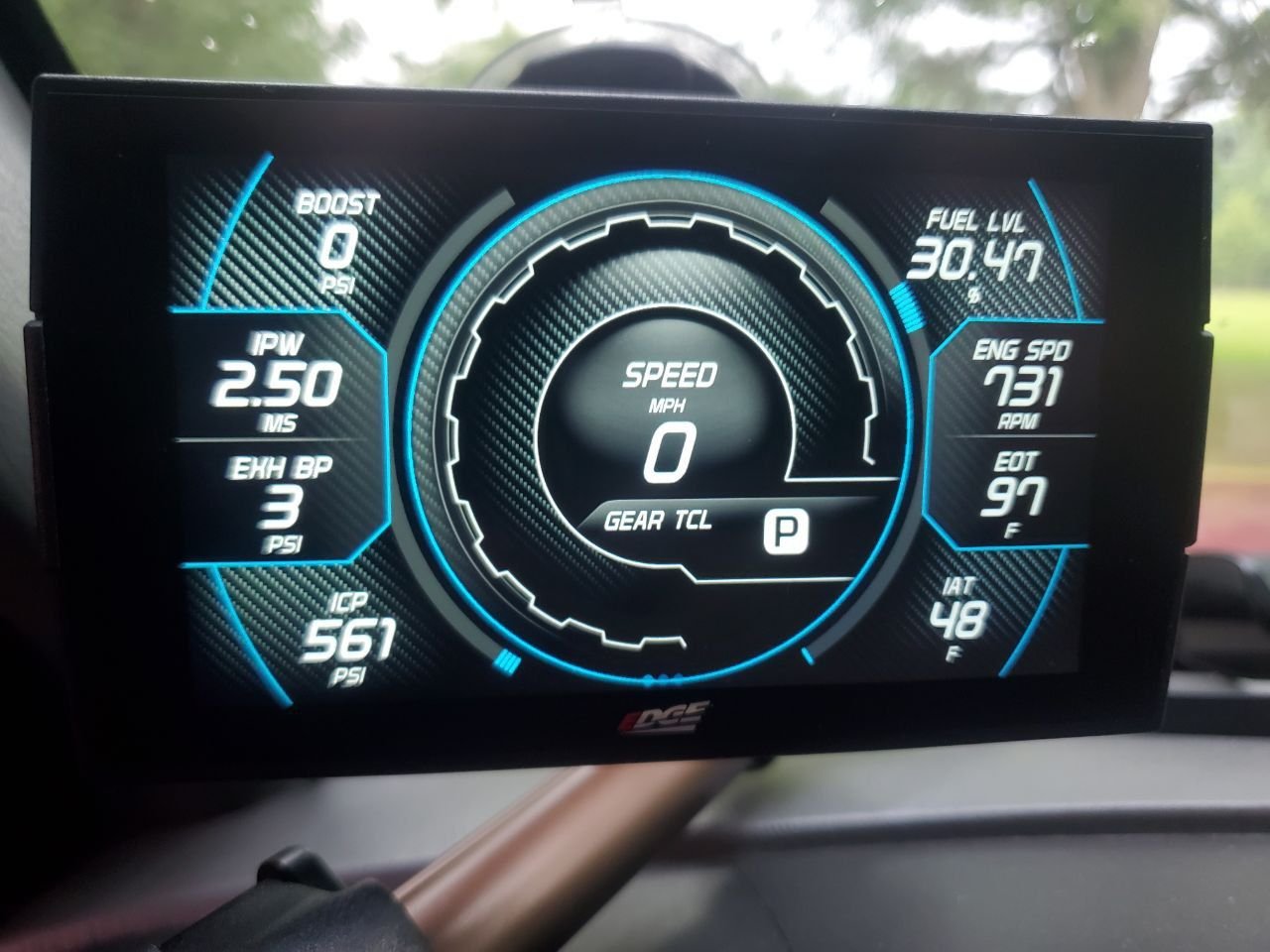

FWIW,
I have noticed IAT is always way lower than the true Ambient.
have not looked into the why, suspicion it has to do with where the sensor is placed, Venturi effect? causing a Temperature drop?
I have one snapshop showing it close to Ambient, but this was on a 100*F day and I was pushing hard pulling 8k trailer load.
100*F  outswide temp
100*F outside temp
an average day, don't recall the exact outside temp, but wasn't wearing any jackets for sure.  Just a T-Shirt
