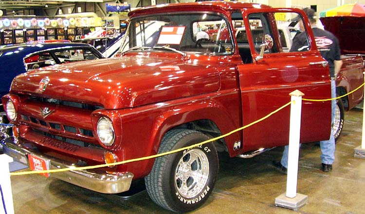

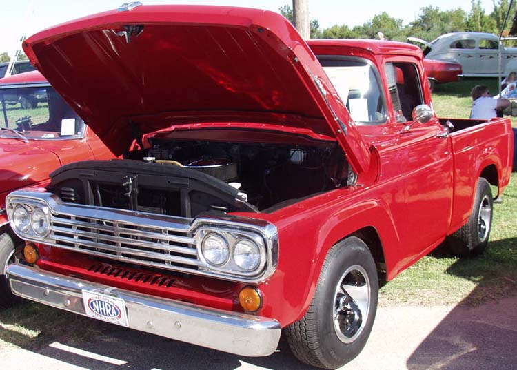

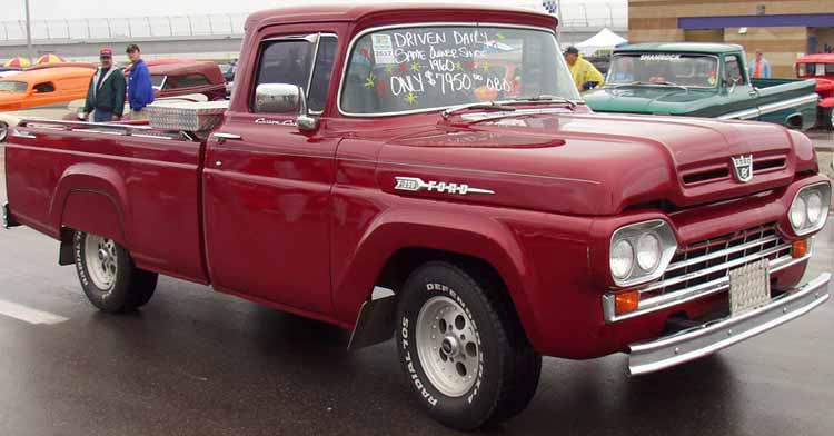

I think there might be some slight differences with the grills from the two trucks that might get in the way. I think its mainly with the lower valance panel and how it attaches to the fenders but I'm not 100% certain. Hopepfully one of our "frigerator" experts will be along shortly and can give you a better answer. Here's a couple of pics, It looks like it won't work;
1958
1960

It looks like the 57 and 58 would swap
1957

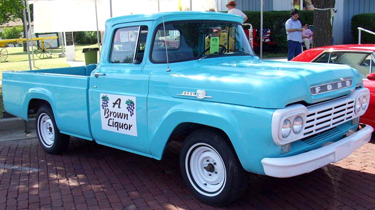

Here's a 59 as long as I'm stuffingpics in a post;
1959
From the looks of it the 57 and 58 will swap out with each other and the 59 and 60 will swap out with each other but the 57/58's will not swap with the 59/60's unless you swap the fenders also
Bobby
