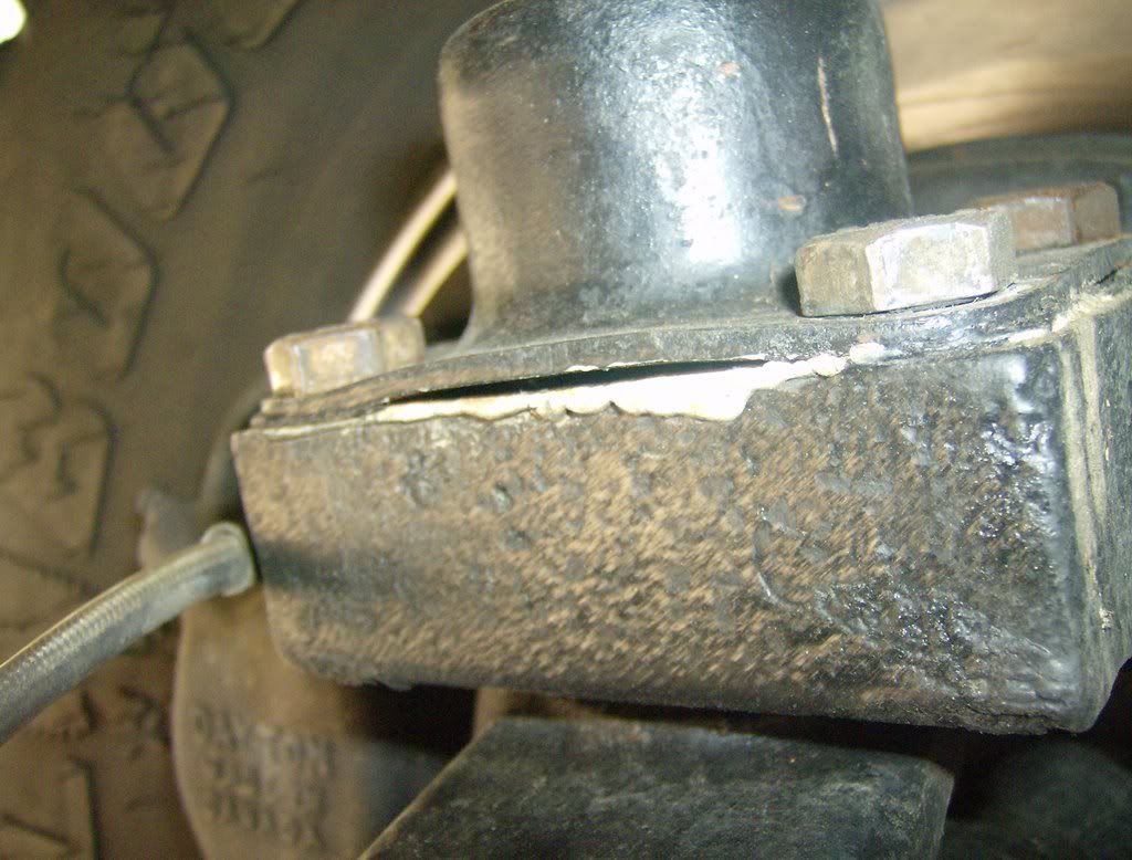

Be carefull when installing some shims under your D60 king pin cap. This can happen if you are not careful:

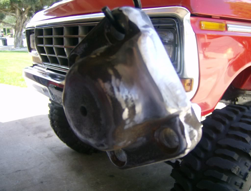

A stock steering arm can be cut and modified to become a much better spring cap:
It will look like this when complete. No flex and a far better seal here:
