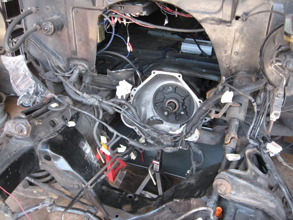

Here is where I am at:
I have a 54 with a Ford EFI motor, AOD trans and Camaro subframe. The PO had the motor set so far back. The firewall was recessed 8". The oil pan sat on the front crossmember literally. I pulled the motor and cut out the motormounts and cut out the recessed firewall. I really don't understand why the motor was set so far back. If you have a Camaro Subframe with a SBF please point me in the right direction.
I cut out a 56 firewall at a "junkyard". But its not the greatest shape - some rust. Is there a repro replacement?
As far as the Camaro Sub/ SBF please help. What oil pan are you running? Can you pull the oil pan without pulling the motor. Did you have to change the oil filter to a shorter one? Did you have to modify the floor?
Sorry about all the questions butI really need advice.
Thanks in advance,
jk

Rustfarmer, Your not gonna find many on here with a cheby front end. The PO of my 53 stuck a 78 Camaro frontend under it and then gave up on the resto. So I picked it up cheap. Swapped out the GM 10 bolt rearend for a ford 8.8 but decided to leave the frontend. Go to my gallery and look at pics in the "Begining" folder. I have some that I will try to download tomorrow (I'm at work now) that has the rebuilt motor installed.
I am running a 351W with a C6 trans. I don't know why your firewall is cut like that. Mine is original and the valve covers and everything clear by an inch or so. As for the oil pan it sits about 3/4 to 1 inch off the crossmember. Wont pull that baby without pulling the motor. Looks like my motor mounts are futher up and outward from where yours was mounted. Hope this helps. Lakota

Lakota, Thanks! I was checking out your gallery pics last night. I really can't figure any logical reason that the PO mounted the motor so far back. Your pics prove that a SBF can fit with the stock firewall. The oil pan is the only bummer - since it can't be pulled without removing the engine. Slipping a SBC in there seems alot easier. Heck I have a 327 and muncie sitting in the garage....?? But, I am looking forward to seeing more pics of your setup.

Wow that firewall hole looks familiar, although it does look a lot neater than the one that use to reside in my 53 I think it was cut with a sawzall and a beaver LOL
I just finished "fixing" it last month... there are aftermarket replacements available but I made my own from sheet metal....... I haven't taken any pics yet but I should update the gallery....... I moved the engine forward 4 inches to get it out of the firewall.
Although it isn't a Chev frontend, Volare, I assume the PO placed the engine so far back to get the headers to clear the dodge steering box, or possibly that he didn't want to get a longer driveshaft who knows

Have you checked Mid Fifty for your firewall repair panels, seems to me that they sell them. Why not just replace the whole thing with a smooth flat panel of 18 ga sheet metal from fender mount to fender mount? You don't neeed the center indent Ford put in it to clear the SBC rear distributor
When switching to an IFS with a SBF, most use the rear sump pan and oil pump (Ford calls it a center sump?) originally made for the Bronco. AFAIK Ford still sells them thru their performance parts division or they show up on ebay regularly. I suspect your POS set the engine back to clear the crossmember. I don't think you could pull the pan without lifting the engine with a SBC either, but the OEM rear sump makes crossmember clearance easier.
