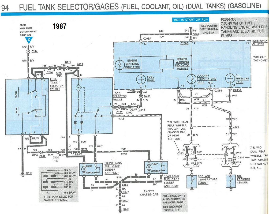

Hey just circling back on this thread. I have an 84 E350 with the 460. It was running great on both tanks but somehow died over the winter. It will run perfectly on the rear tank but when switching to the front the engine dies. I have repeated this while driving a few times to see if there was air in the line, not luck. I am thinking it is the front fuel tanks pump or the switch. Is there a way to test the switch?

This should be close to what you have.
Attachment 281593

This should be the 1984 diagram. Shoot, I think I got this from Subford too.

Don't discount the Fuel Selector Valve. As you can see, it determines + (positive 12v) electrical flows to the fuel pumps (and sender units), so it needs to work!
The fuel selector valve does not send power to the fuel pumps. The selector switch does that along with the tank selector relay.
The fuel selector valve switches the fuel gauge and aligns the tank fuel lines to the fuel line going to the engine.

Yes, sorry. Poor choice of words. I do realize there are two "selector" devices involved here. The tank selector relay is what I meant. The "system" in my older 1988 dual-tank works a bit differently, with a fuel selector valve that is a "passive" device, no electrical connections.
