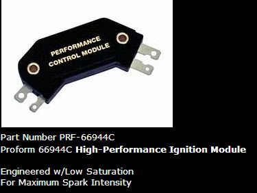

The engine is a 351M. I can't just replace the module in the inside of the distributor. It is a Proform HEI distributor. They don't sell just this module that is cracked.

Are you sure? About $20. And this should be the firing order for your motor....13726548 firing order

It is not that part that is cracked. It turns out that it is just the cover on the part that attaches to that part. I pulled the distributor and the valve cover and made sure I was at TDC on the compression stroke, reinstalled the distributor and adjusted the idle on the carb and finally got it set. Thanks for all the input.
