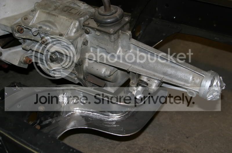

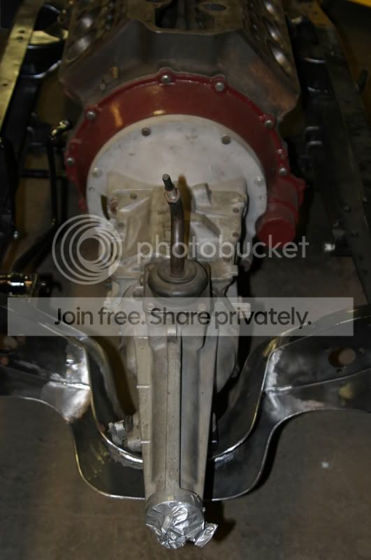

To finish off my thoughts on this build, I found the correct bellhousing to mate the rebuilt T-19 transmission to the french block. The T-19 will give me the same location for the shifter and forward gears will be syncro which will be a real up-grade over the current crasher 4 speed. Looks like the biggest mod will be the tranny crossmember. Anyone have any thoughts on this set-up?

If you can find the cross member from a F-2 or F-2 you might be able to use it. This cross member dip lower than the F-1 and should be a fairly easy mod.
On the Bonus Built there was a person who build a really nice cross member but since the BB has gone dead I can't give you a link to it. I think the same guy is a member of this board but I can't remember who it is and if he had pictures of the cross member in his gallery here.
There's some info in this thread, check it out:
https://www.ford-trucks.com/forums/6...e-mount-2.html

I found the thread with the custom made crossmember pictures I posted:
https://www.ford-trucks.com/forums/6...-50-f-1-a.html
