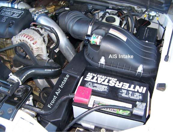

Originally Posted by PaysonPSD
AIS in my early 99.
Looks good.I'll ask Santa-aka wife-for one for Christmas

Originally Posted by UP_There
I was thinking the same thing. The main reason the stock setup tottally sucked was those clamps never seem to make a snug airtight connection all the way around the box.
If you remember the stock box had two clamps on one side and two plastic tabs on the other, the plastic tabs tend to break off and then leak.
The AIS has four clamps, one at each corner, and seal much better than the stock box. The biggest problem with the AIS IMO is the cost and availability of the filters, that's what made me switch to the 6.0 filter.
