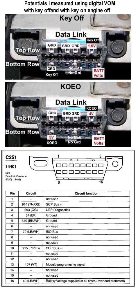

i need help i have an 2002 f-350 (7.3)i have afe intake,4 in turbo back exhaust, 4 inch lift with 37in cooper discovery tires shoved underneath........heres the problem i bought an accel diesel tuner and it wont even power up on my truck so i tried it on my friends 2000 f-350 (7.3)and it powers up and starts reading right away.....whats going on? is it possible theres been another programmer loaded on my truck and it not letting my programmer work? please help

Welcome to FTE.
Check the fuse for your cigar lighter/data link. Should be #3 20 Amp, check your owners manual.

I agree, check the fuse. Besides, I think the programmer would be VIN locked, not your truck!

+3.
I freaked for a second when I couldn't get my scanner to work on my Excursion. Once I changed the fuse, no problemo.

thank you
thank you for all your help i am going to the auto parts store and buying a new 20amp fuse today and crossing my fingers i will let you know the outcome

Old Oct 29, 2008 | 06:18 PM

Here are the potentials I measured on the Data Link pins. Your findings may vary slightly
according to battery voltage. Pin 16 is supplied battery voltage from fuse panel.

it worked!
hey thanks alot guys i went and pulled my f2.12 fuse and it was blown (i didnt have any spare fuses left) so i went and bought a new pack of mini 20 amps and it works like a charm my truck runs better than i ever imagined with the new programmer i really appreciate all the help and cant wait til i can contribute some help to others in the forum
