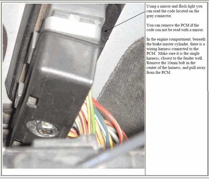

Andrew, you should have a VDH* PCM in your truck. My '02 has a VDH2 PCM. The way to tell is to pull the PCM and look at the sticker on the connector. If you know where to look, you can see it with a mirror and a flash light by looking at the PCM connector (the side closest to the fender). It comes out so easy though, you might as well pull it and save yourself the contorted positions... LOL

Originally Posted by 87 F-150 I6
how do you find this out
Here is what Joe was talking about in using a mirror. If you have a small digital camera you can take a pic easy enough.
It is below the master cylinder.
