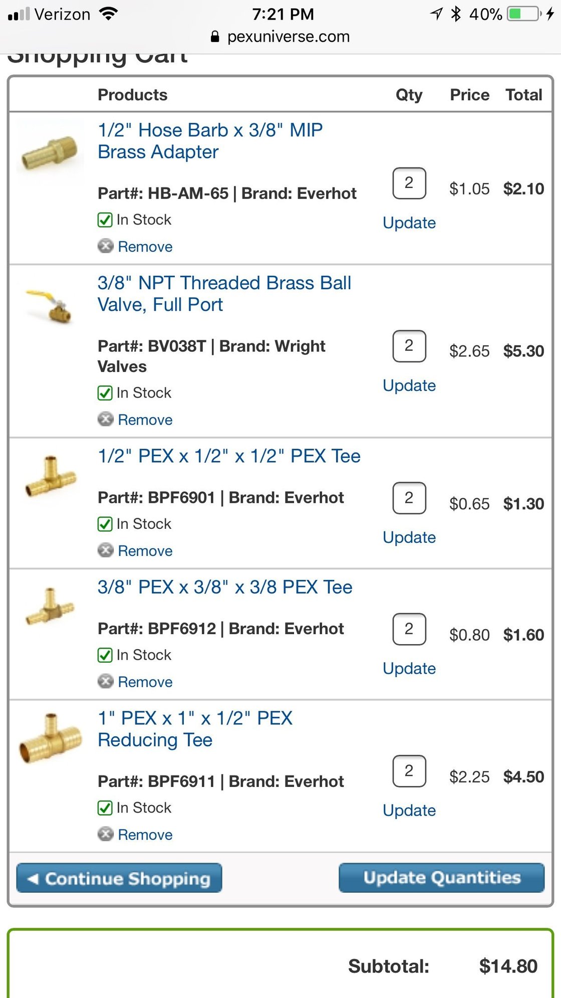

i was able to find all the brass fittings and ball valves at pexuniverse.com

I could NOT get a reinforced hose over the 3/8" PEX fitting and I tried every trick I knew of...
All those PEX fittings are at Home Depot, so you might want to see if you can get a hose on one before you buy a bunch of parts. My parts cost was only slightly less than the XDP kit I ultimately installed -- and it is a oh-so-much cleaner looking install...

Pex fittings are sized to the fitting, so a 3/8 Pex ID is way too large for a 3/8" hose.
