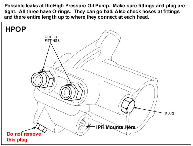

isnt the HPOP underneath the fuel filter bowl or am i wrong..i first thought it was the rectangular thing...but then where is the plug and fittings that i check for a leak...also is it easier to check for the leaks under the truck or under the hood

ok thanks....i have the diagram of the HPOP but where is the plug for the HPOP and is it reachable from the top of the engine?

im fixing on tryin to find this leak again tomorrow...so where is the bolt under the fuel bowl and is it accessible from atop the engine?
I think we're talking two different things here. The plug on the HPOP *RESERVIOR* is on top easily accessible with little effort. There is a plug that can leak on the *HPOP* itself -- it's on the very back of it and is MUCH harder to get to.

yea thats what im tryin to get at here is the plug on the HPOP to see if thats where i have my leak from....how do i get to that and unscrew it once and put on some new orings?

I think I found what you're looking for here:
https://www.ford-trucks.com/forums/5...ok-here-2.html
Here's the pic worth a thousand words:

I had mine leak before in the pic that Joe posted above, arrow pointing at the "plug". Good post Joe, went to add rep point but it sai you were not worthy until I spread it around LOL.....

so i have to pull out my HPOP to access that plug...i thought that u were able to access it while still in place...i duno...anyone who had to replace this o-ring take their HPOP out completly?....thanks for the help IZZY

Thanks guys. You should be able to get to those O-rings, but it's a little tight in there. No need to pull the pump.

so your able to swing a wrench in their tho... ill have to take a mirror tomorrow to check it out and just make sure..
