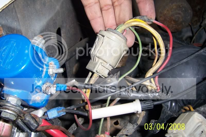

comming off of the 12 side of the battery the cable goes to the starter solenoid then branches off to the wiring harnesses. Am I correct that the yellow 10ga wire that has a large fuse link (fenderwell area) is the wire that feeds the ignition? http://i134.photobucket.com/albums/q...e/100_2210.jpg I found 4 fuse links in the bundle (there were two on each wire). But I don't have voltage on either side of the links. Where does the voltage originate from. http://i134.photobucket.com/albums/q...e/100_2209.jpg
also there is a wire going to the voltage regulator that looks like it used to have a link attached to it - the other side is attached to the starter sol.
FyI. The truck had power the day before, the next morning I tried to start and there was no power. I tried to jumpstart 1st with my battery charger (no Luck the battery was too low). I have since found out that the brake light switch had come loose draining the battery.

you are correct about the yellow wire. And it gets power from the battery terminal on the starter solenoid in the picture below. At least, it originally did from the factory. Somehow, someway, the yellow wire is connected to the bat terminal of the solenoid.

From battery side of starter solenoid to Green or Orange fuse link (depends on which alternator you have). From that link to a Black/Orange wire (through a couple of splices) to a Yellow wire through a Connector to another Yellow wire to the junction of two fuse links, one Green the other Orange. The Green link connects to another Yellow wire to the Ignition. The Orange link connects to Black/Orange wires feeding headlights and other circuits. I'd start at the battery terminal of the solenoid with a voltmeter or test light and follow each path and probing each connection until a loss of voltage is detected. The colors and routing comes from my '83 manual but I think they're the same on yours.
