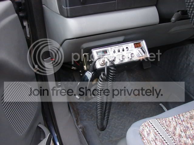

Me and two other friends all put ours here. Mines in a 250, both theirs are in 150s(the interiors are closer to the new 08 SDs). Its a Cobra 25 (a 29 fits, but it kept hitting my knee). I used one screw right in the middle of the bracket and then velco. Hasn't fallen out yet, and since its one hole I can put a bracket in for the 29 no problem.

I mounted my cb in about the same place as texas tech, just farther to the right about a foot where it wouldn't hit my knees. I actually used heavy duty velcro to mount it, but its a small radio and maybe once every couple months, I find it laying on my floorboard. mehh..it does what I need it to. My antenna (4 ft. whip) is on my mirror because I have the 2 arm mirror, but the roof would be good for a magnetic mirror. Or if you have a tool box, they make brackets for mounting it there. Because my mirror is plastic, I had to run an extra wire it just to ground it. But if its connected to someting metal like the roof or toolbox there shouldn't be a problem. And yeah there's not much sense for 2 antennas unless you are using the second for someting else.

Heh... I used a 41-inch bungee to strap mine to the front of the center console. Out of the way but still easily reachable.
