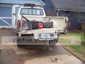

well its not pretty, all the body parts i need i can get through junkyards correct??? oh and he's asking $1400 on craigslist i was thinking about offering him $950 what do you guys think about those prices?!?
heres the pics that i have.

The truck is worth $1500 in parts alone, at least thats what it would go for where I am. Trucks from 1987-1996 are really easy to get body parts for, a complete cab in good shape can be in the $400 range, same for a box (but they can also be up to $1000). Reproduction hood, fenders and doors for $150 a piece. If you're not in a hurry, you can shop around for the best deals and slowly replace the body piece by piece.
I have a feeling he may not go for $950, but thats where a counter offer comes in and given its poor visual appearance, I would risk a $950 offer. Just give it a good look all over, and put it through its paces when driving it. Check the rear of the underside, sometimes rust on the frame can be bad enough to cause structural damage.
Does it track strait? the pictures of the side look almost like the frame is a little bent.

ok cool thanks david, im headin out to check it out right now, and im in no hurry to make it look pretty but i do plan on it if i buy the truck, what would you offer for it just by seeing the pics? you have just about as much info as i do about the truck. oh and that side dent your talking about the first owner of the truck fell down a hill and it hit a tree so you may be right about frame damage ill check it out while im there.
