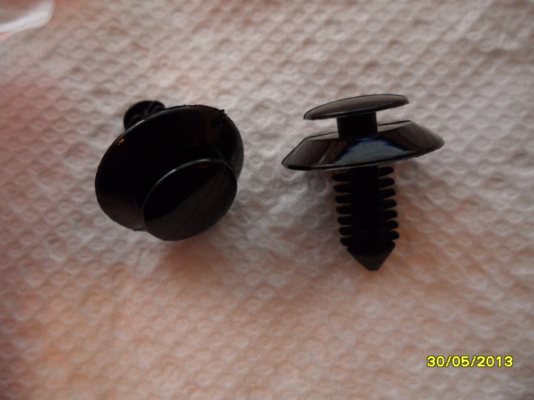

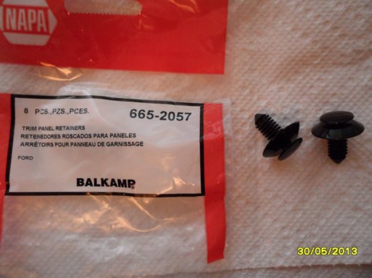

Door Trim Panel Retainers, black: Au-Ve-Co 12565. I buy them in a box (25) at a time. My box says this on it:
Ford
Head Dia: 25/32
Stem Dia: 5/16
Stem Length: 5/8
Black Nylon
NAPA has one that fits as well: Balkamp 665-2057 (package of (8) pieces). I have an empty NAPA pkg stuffed in the bottom of one of my Au-Ve-Co boxes, so if I need some in a hurry I can buy some at NAPA.
Early doors take (11) (Ford dealer used to sell them in (10) packs, which drove me nuts: every time I'd do a panel pull, I'd be one short, or have nine left over!)
Late doors I think take only (10), but not certain. They do take ten or less, that I'm sure of.

I had to replace a bunch of these that the previous owner had re-used on the back hatch panel today.
