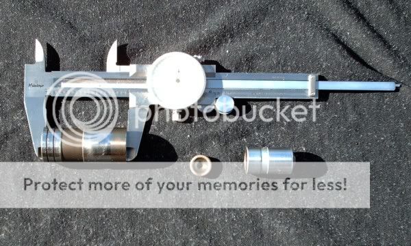

Check the travel of the piston in the lifter. externally a 302 lifter and a FE lifter are identical, but the FE lifter has about .2" more travel before bottoming.

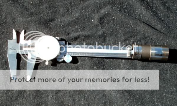

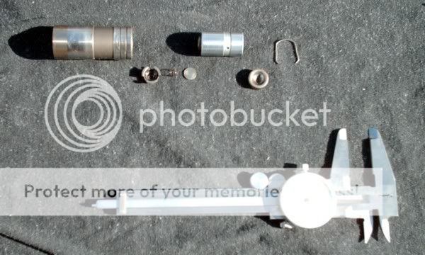

Would anybody happen to have the exact length of travel for a 352 lifter? Or, is there an easy way to measure it? Actually, does anyone happen to know what the length from the top of the lifter to the bottom of the stroke (with plunger removed) to check? That way, I could pinpoint my problem. You guys are super helpful, Thanks so much
1.447"
You might want to compare to the lifters you already have.
Quick question: Where do you find this information?
Actually I made that up...sorta. After thinking about it, I did not like referencing from the top. I have read that different brands may be different lengths?
So, to give you some real numbers for comparison, the shell measured 2" overall.
With the two parts of the plunger installed and bottomed out I measured 0.627" to the top of the shell. HTH
