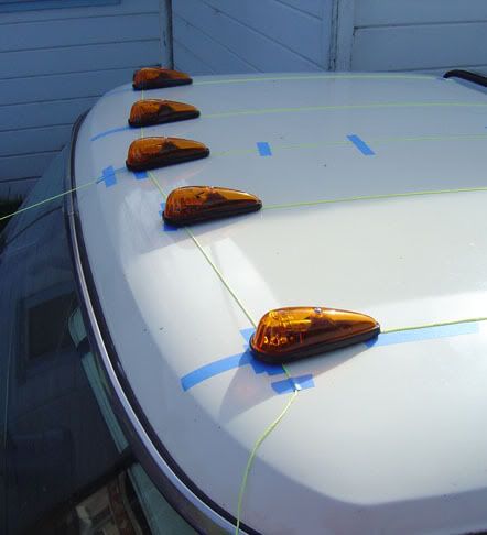

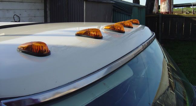

ALL DONE!
PICTURES!!
Please leave comments!

Real nice job looks like you went at it very thouroughly with the taping and lines.Only thing I was wondering is do you think you put them a little far forward or did you want them that way ?

I followed someone's measurements on a previous post, on another thread about clearance lights. I have the center at 2-1/4 inches from bend in roof above windshield. Other 4 are 3 inches from the bend in the roof. Center 3 are 9.5 inches apart from each other, and the outside ones are 13" apart from the others.
