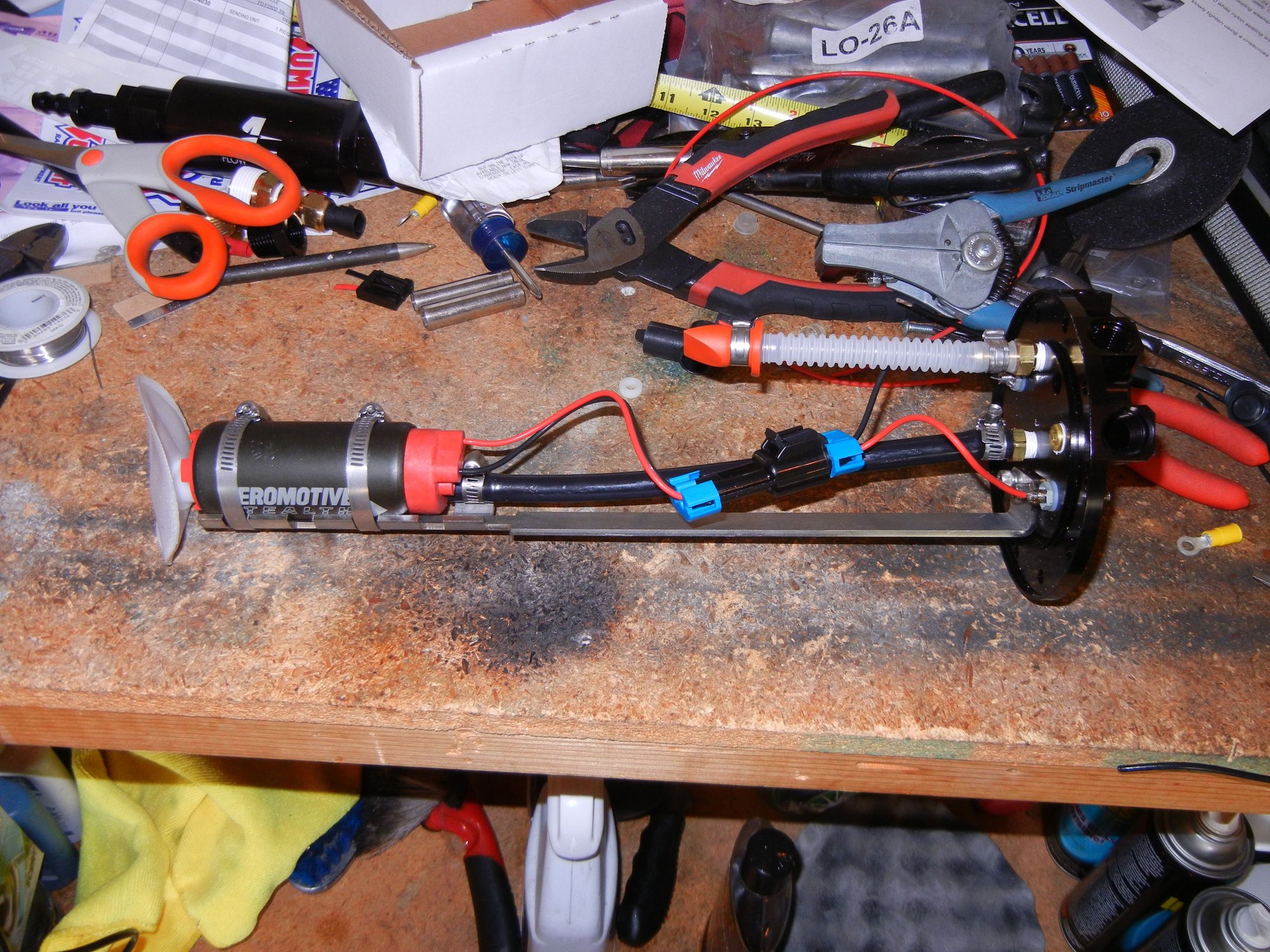

Once I chose the EFI kit, I then had to figure out fuel delivery........FiTech has what they call the Fuel Command Center, but in my research, there are some inherent difficulties with that setup that I didn't want to deal with. I could have also gone with a simple inline pump, but I didn't like that inline pumps tend to have a shorter lifespan than honest in-take pump setups. So, while I knew it to be more expensive (like anything on Buford has been dirt cheap), I opted to go with the Aeromotive Phantom 340 fuel system. Before I could use it, though, I had to figure out what I was going to do about my dual tanks.

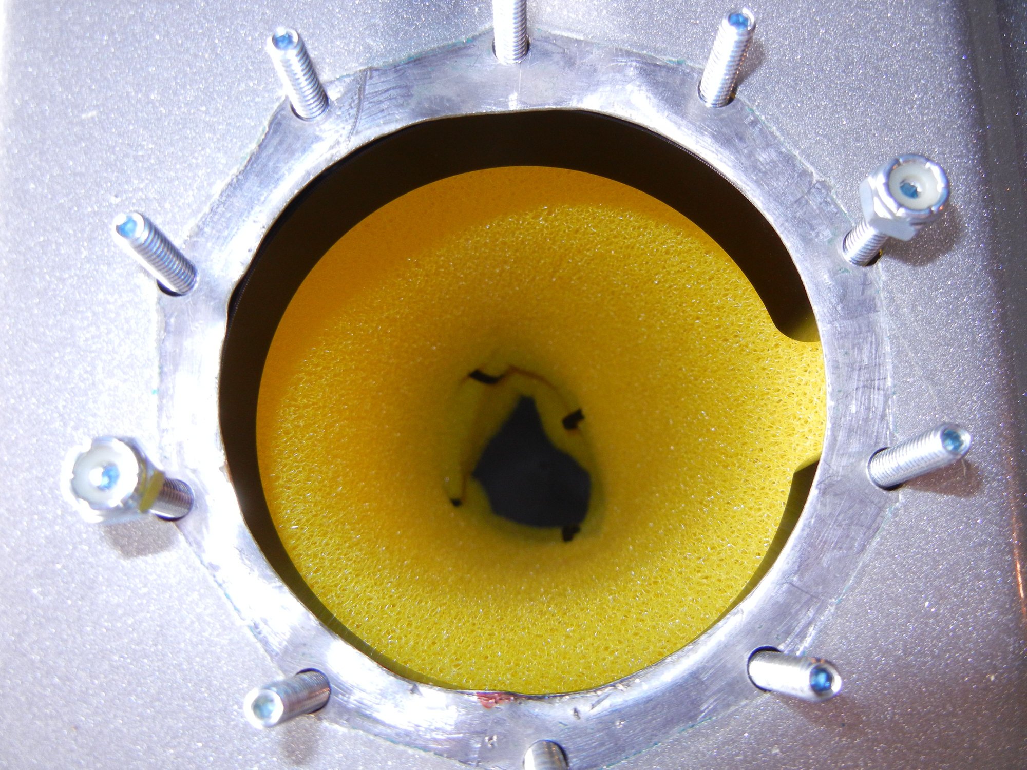

I liked that Buford had dual tanks, but for an EFI fuel system, it suggested more difficulty and cost than necessary. For proper EFI supply and return on both tanks, I'd have to buy redundant systems, and route them through a marine grade crossover valve, and that all just sounded ridiculous to me. So, I went and got a double capacity rear tank, and got rid of my saddle tank. Buford would still have a 38 gallon capacity, but it would be in a central location. I then had the tank professionally cleaned, then took it to be powdercoated (as it has to be all spiffy.....I truly need psychological help). Once that was done, I installed the pump assembly with the big yellow sponge baffle that's supplied by Aeromotive. The purpose behind this baffling, is that it sits in a sort of rubber bucket at the bottom of the tank, and the pump sits in the bottom of that bucket with the baffling surrounding it. The purpose behind this is that the baffling will catch any splashing fuel, and route it down to the pump so that it never suffers from a starvation event. If you notice, the extension piece of baffling I had to use was going to be a pain in the butt to be able to put down into the tank unless I could come up with some way to connect it to the bigger piece. So, I came up with the idea to use the zip ties to pierce each piece of baffling, and loosely connect them together so they served as one piece. I told the folks at Aeromotive about that fix, and they said they may include that in their instructions for the extension kit, and include some zip ties to do the same (every once in a while, I come up with a decent idea). Anyway, once the baffling is in the bucket, there are four holes at the bottom of the bucket so that the fuel level can equalize, but the pump remains submerged as long as possible.
Now, with getting the 38 gallon tank, there was the issue of extending the pump assembly. Aeromotive provides a pump extension kit for these circumstances, and you just have to measure the necessary spine, and cut accordingly. You then need to plumb the pump to the head assembly over the longer distance, and extend the wiring as well. This is all basic plumbing and wiring, but you get the idea.
One of the bigger issues was the adaptation of the fuel sending unit. Firstly, it was aimed directly to the center of the tank, which is where the pump went. So, I managed to bend the tubing for the sending unit on a 45 degree angle, away from the pump, and closer to the filler neck. I also measured and positioned the sending unit so that the float would reach the bottom of the new tank. The issue here is that the sending unit will read "Full" from 38 to about 19 gallons left in the tank......from there, it will read as normal. So, when you start to see the fuel gauge needle move, you have half a tank left. Granted, it's still 19 gallons, but the big issue is that I wanted the gauge to read "Empty" when it was actually empty. That's waaaaay more important than full, in my mind.
Once I got the pump put in, I reinstalled the tank with the newly powdercoated extension hardware that can accommodate the larger tank, and got ready to put it back into the truck. Before I did that, though, I plumbed the head unit with enough hose so that I could connect the hoses to AN unions once the tank was installed. I've got the supply line leading to a 10 micron filter, and the return is on a simple union. The vent line I sent directly to the original equipment charcoal canisters on the passenger framerail, as they could still serve a purpose.
Once I got everything plumbed, wired, and got the linkage set up, I then did the baseline programming for the EFI setup. It's a very straight forward process, and once I got that done, I filled Buford with fuel, said a prayer, and got ready to turn the key. I turned the key to the "on" position, and waited for the fuel pump to prime the injectors, and I waited until I heard the telltale "click". I then went to start Buford, and he fired right up. The computer has to learn your driving style, and fine tune for your programming, but it seems to be smoothing out the more I drive it.

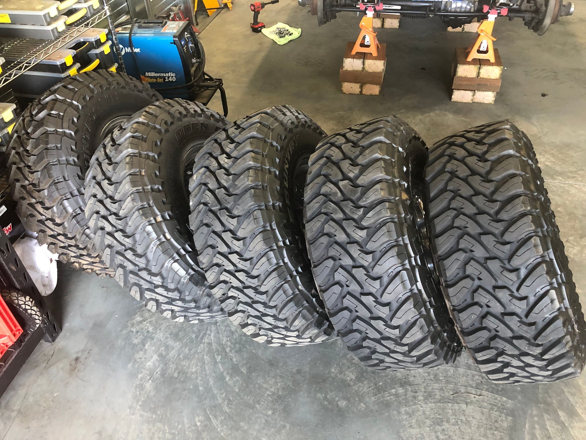

I've also had to remove Buford's tires, and get new ones, as while the tires only had 5000 miles on them, they were 15 years old. I couldn't have my truck rolling around on geriatric tires, so I sold the old set cheap, and got a new set of the same Toyo M/T's. I also had the wheels professionally polished while I had the rubber off, so they'd be snazzy when I put them back on. For now, Buford is sitting on six jack stands, waiting for me to get to work.
So, I'm sorry I haven't been around a lot, but since Buford has been in storage for the last five years, I've not had much to blab about here. That should be changing a bit as i've now purchased everything to make all my upgrades. I managed to sell one of my cars this summer, so it gave me the capital to be able to buy all the new toys for Buford. Hopefully, over this winter, I'll be able to show you guys what I'm doing, and have it done by spring. That's about it for now!
