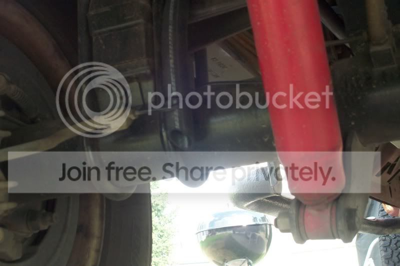

Mine is vented to the atmosphere. It's right at the rear end just like this:

Do you guys ever get oil dripping out of the end onto your driveway/garage floor? That is one thing that I am worried about when doing this mod.

so far my tube is dry on the end, i didnt notice any dripps.

Mine has never dripped onto the driveway. That was the main concern for me and the reason why it took me so long to do that mod. I hate oil leaks and drops on my white concrete driveway. After talking to a lot of the guys here and getting tired of oily boots I went ahead and did mine and am happy with it. I routed mine out of the doghouse and then over the master cylinder. From there it's a nice slope to the rear end along the outside of the frame rail.

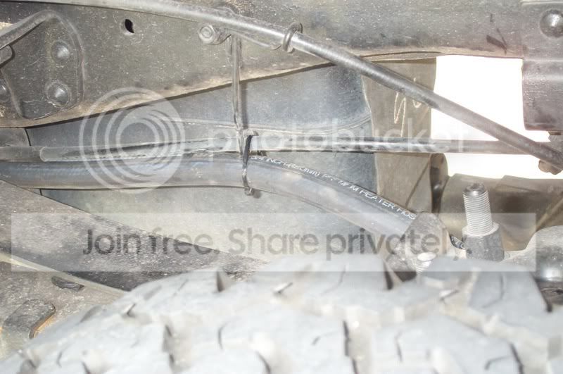

I'm one of those "trap" guys. Since my trap went in with my re-routed hose, I can't speak too much to dripping issues except that my trap catches about 2-3 ounces of oily condensate every couple of months during the cold weather periods, which to me implies that it would have otherwise dripped on the driveway had the trap not been there.
My routing pics and trap pics are in my gallery.
