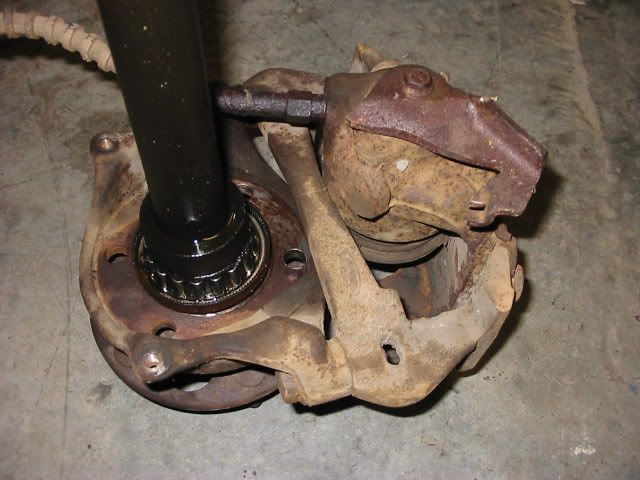

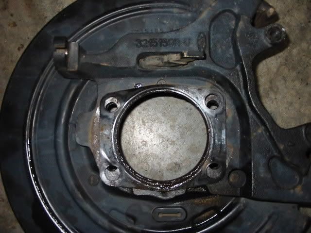

Depending on what style flanges your rear has, you can readily find parts in the junk yard to convert to disc. On my EB, which has early small bearing flanges, I used the brackets, calipers, and rotors off of an early '90's Grand Marquis.
If you have an early model big bearing you can use the Lincoln 9" set up. But they are getting hard to find in the junk yard.
And if you have a newer big bearing or Torino bearing it is sometimes called, you can use a mid '90's Explorer set up. Sorry I don't have a pic of the complete set up but here is one of the backing plate comapared to the gasket for the early large bearing.

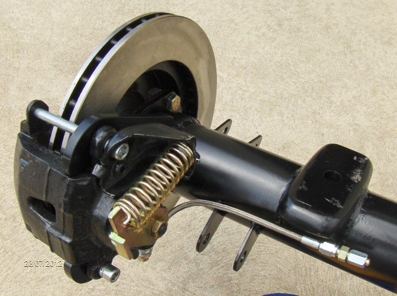

Several companies make these kits, I bought mine from BCbroncos.com. I have about $500 or so in mine with cadillac calipers with parking brakes

I did a rear disk swap using the front rotors and wheel studs off a 78-79 F150, than a $10 weld on brake caliper bracket, and some chevy s10 calipers.. the rotor needs to go on th eback of the axle flange, so it needs to get a notch cut into it so you can bolt the axle in. but it was symple and cost about $125 when all said and done. If i need to i can go take some pics.
