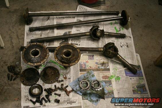

Thats what I've heard too, but Blake gave me free new zipper boots for em, so I guess I'll run them until they rip. What sucks is once they rip and you go to replace them, you either use the zippered boots or take the knuckle off and use the solid boots. Anyways, judging by the old pair that came off my axles, I think that they seperate where the zipper-cloth is glued to the rubber. It didn't take any effort to free the zipper from the old boot.
Progress after day 2:
