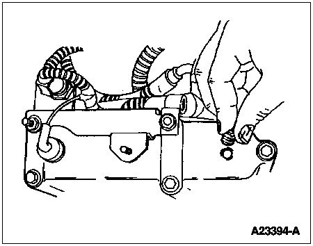

Ok just to clarify, after the engine is warm is when it doesn't start right? Does it start fine when the engine is cold? If it doesn't start hot but does cold then you probably need Injector pressure Regulator (IPR) o-rings. you can buy a kit from ford to replace the o-rings. what happens is the o-rings get worn. the cold oil can fill the gap and build enough pressure to start the engine but the hot oil is too thin to fill the gap and won't build enough pressure.
here's the part numbers
IPR O-Ring Kit (for when IPR valve replacement is not required)
(Ford) F6TZ-9C977-AN (F6TZ-9C977-AA?)
(International) 1825806C92 (1825806C91?)
