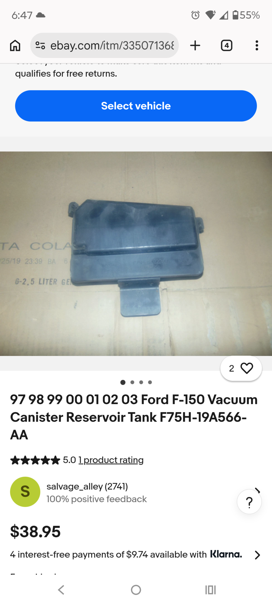

Originally Posted by Don Ridley
The accumulator tank (vacuum reservoir) on Econoline vans leaks eventually for almost everyone. Check yours (it's impossible to change in vans). This tank stores vacuum for periods when the engine is under high load. The system defaults to defrost when vacuum is low.
It makes me wonder if one could spray, paint, dip something on the outer surface of that little tank to seal it, or would one just have to buy another vacuum tank?

That sounds like a possibility to seal that tank, but on my ‘03, what went sideways is the vacuum line that tees off the vacuum tree and darts right into the firewall. That hose was all chewed up. Heat must have broken it down over time.
You can smoke test the setup just to make sure the issue doesn’t go farther than that, which I am confident of in my case after doing some looking with an inspection scope. One of these days, I’ll pull the battery and tray and try to stab a hose back in there before it gets too toasty outside.
