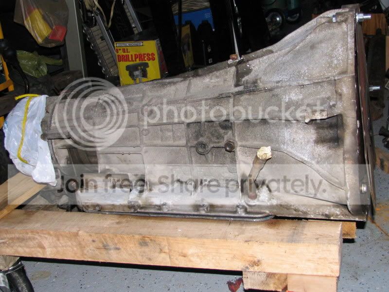

I can't tell you whether the trans you are looking at is good or not but I can help you with identifying one. The tranny code is found on the safety compliance certification label on the driver's side door jamb. Look on the label for trans and the code for an E4OD is an "E". An AOD is "T" and a C6 is "G". The E4OD has 20 bolts holding on the pan and the pan is shaped like the state of Utah. The AOD and 4R70W have 14 bolts. The E4OD also has an electrical harness that attaches on the rear passenger side of the trans as well as the wiring on the drivers side. Here is a pic of an E4OD from a 4X4:
It is a large transmission. I though the AODE in my Mustang was big and heavy but this thing dwarfs it. Be careful taking it out.
