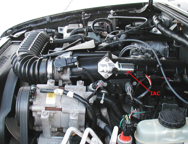

OTB, that hole that GrayRanger pointed out is not good. Like he noted, there is supposed to be a hose running from it to the top of the valve cover on the passenger side. There is a fitting on the valve cover for that purpose. In this pic of my '98 you can get a glimpse of the hose where it connects to the air intake tube :
https://www.ford-trucks.com/forums/a...ntid=516&stc=1
The sensor in your pic is the throttle position sensor (TPS). There is no need to tinker with it.
