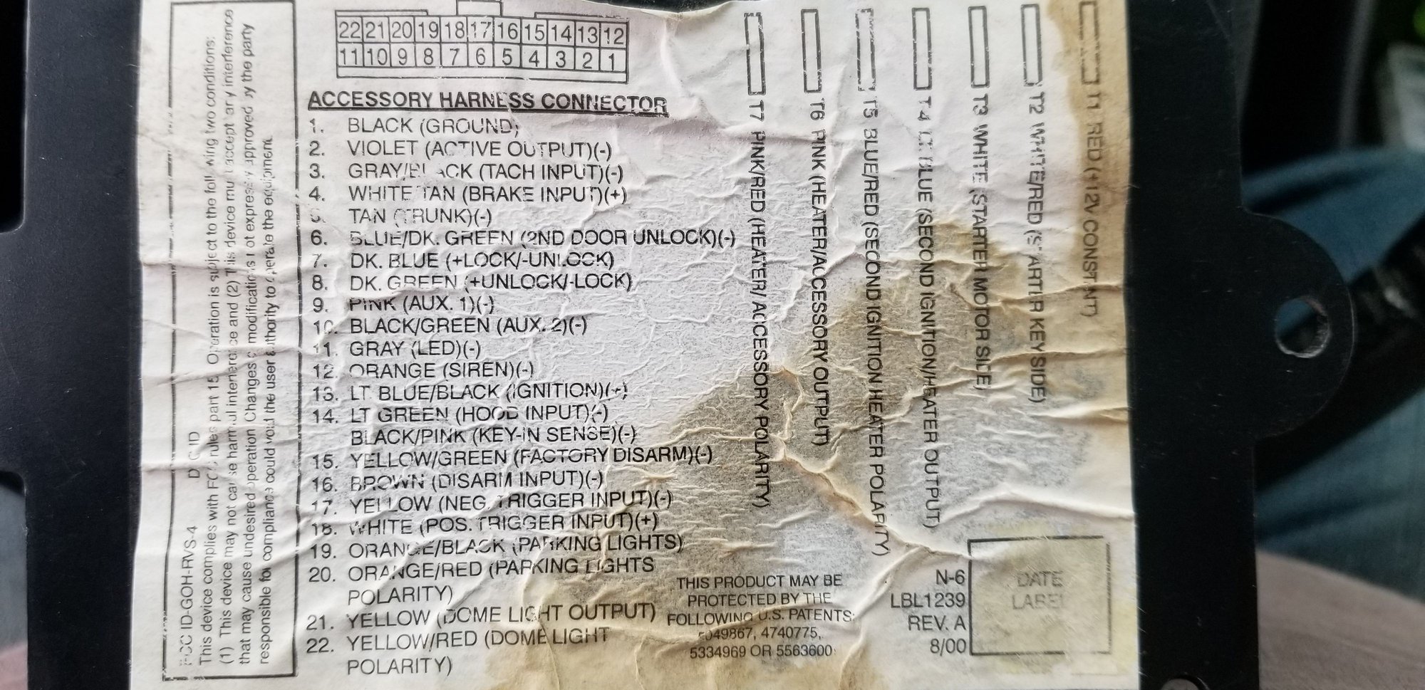

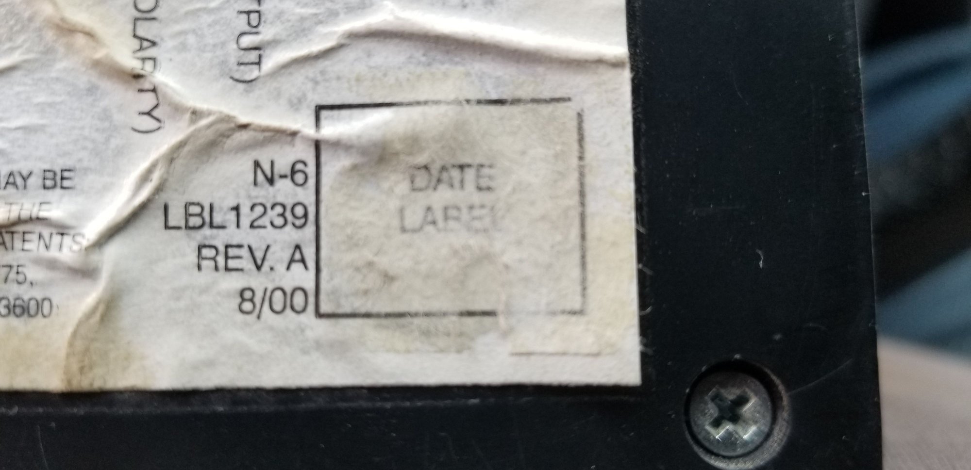

Sorry, the Truck is a 2003 F250 Superduty V10.
The info on the unit under the dash is:
N-6
LBL 1239
Rev. A
8/00
It has a big blue Ford logo on the opposite side from the data.

IF you have an Old Ford Dealership there may be a mechanic left that might know something about them...
While the manual is probably not for the exact unit that was posted in the pictures, it's all I have for Ford....
since it don't have a Ford Part or Index number on it.... I'll bet money that it was made by Code Alarm.. you might find more information on the Printed Circuit Board itself.
a quick search on FleaBay shows me this one that looks similar but I cannot read the back Label https://www.ebay.com/itm/Ford-Vehicl...-/163780469061

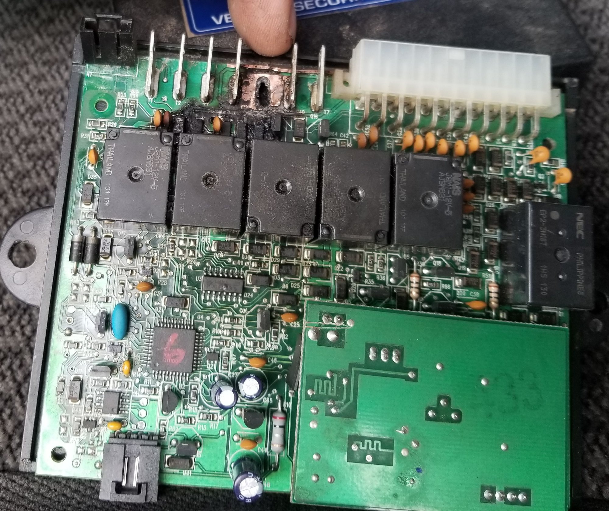

This is the green board, im pointing at the area that got toasted
Googled : code alarm+the above letter number code and got key fob
Back label
Googled: code alarm+the above letter numbers and all i got was key fob
I peeled up the ford sticker to see if there was any info underneath and there wasnt anything.

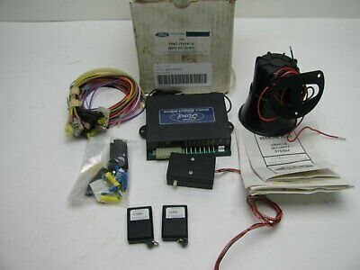

I came across this, it looks just like mine. The only problem is the part number E9AZ-19A361-A I found another one that ended with -H so I'm guessing there are different ones for different model ford vehicles. I just need to find out which one is for a 2002 ford f-350 crew cab super duty V10 engine. Man you've been a MASSIVE help with this issue. Thanks a million.

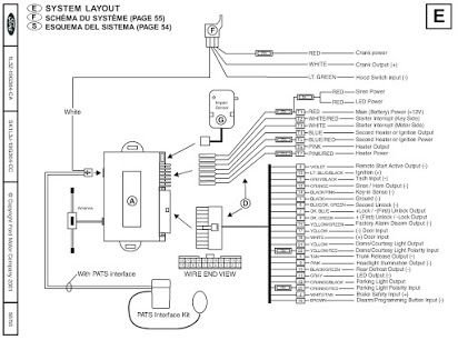

it's 100% Code Alarm
here is a wiring diagram ... Damned hard to read...
IF you search the FCC ID you will find a bit of info but as you have already seen Mostly Remotes.

I cant read wiring diagram. I seen that while digging. Wish I could find installation manual. Thanks again for your help

that Bad Boy you have is pretty Fried too.... even U3 (integrated Circuit) looks fried
Well at least we know for sure it is a Code Alarm unit and Voxx International is code alarm now.. I know it is not available thru Ford anymore and I doubt Code Alarm has any left... but IF you contact them they might help you out ... Number Dummy here might be able to help you with some part numbers
