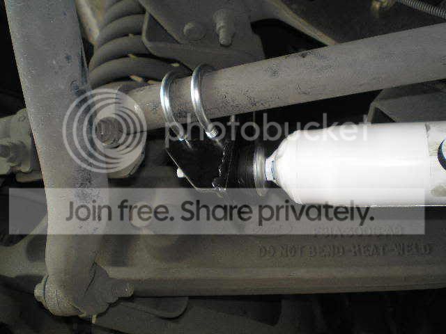

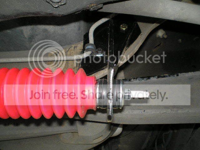

Old Apr 20, 2007 | 07:07 PM
  #58
tims01's Avatar
tims01
Joined: Aug 2006
Posts: 918
Talking
here are my install pics. i did this all from memery due to my www being down and another one and one more but it all went smooth

Looks good Tim!! My site was down the other day due to my cable provider changing my IP without notice. It should be fixed now.
