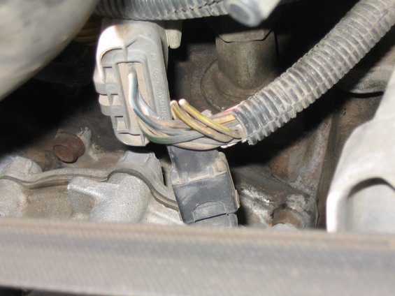

Hey guys,
New to Fords and the site and have to say this a good place to find info but I'm stumped. I have an 1989 F150 5.8L. I've serched high and low for the spout connector and either I'm blind or stupid or both but I can't find it to save my life. Just so you know, I looked all up and down the wiring harnes from the dist and on the driver fender with no luck. If someone has a picture of the spout on the same year and model truck maybe I could find it. Thanks....

88 was the first year for efi on the 5.8 therefore would not be duraspark II here is a shot of the spout connector
http://www.supermotors.net/getfile/1...connectors.jpg its the black connector

now that black connector on mine just has a cap on it, do you open the circut just by taking the cap off?
Old Jan 8, 2007 | 04:49 PM
Kemicalburns's Avatar
Kemicalburns
Joined: Jul 2002
Posts: 14,285
Likes: 12
From: Bend,OR
yes that is correct

Oooohhhhh SMACK!!! Do I feel stupid, Thanks for the info, I'm good to go now......
