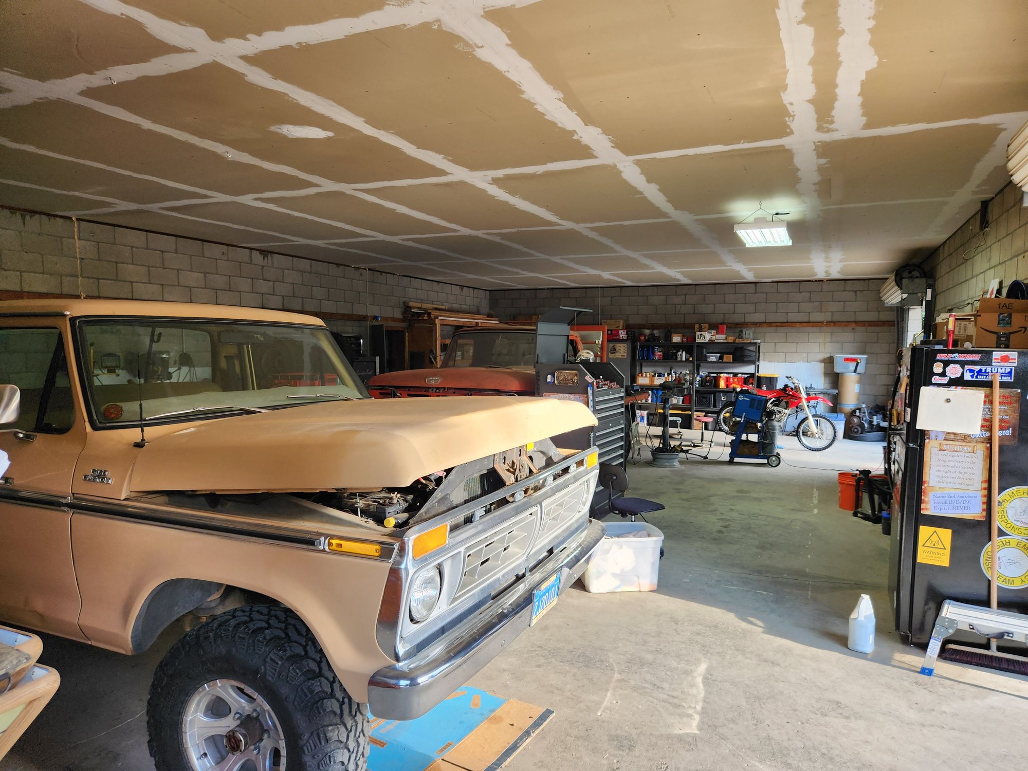

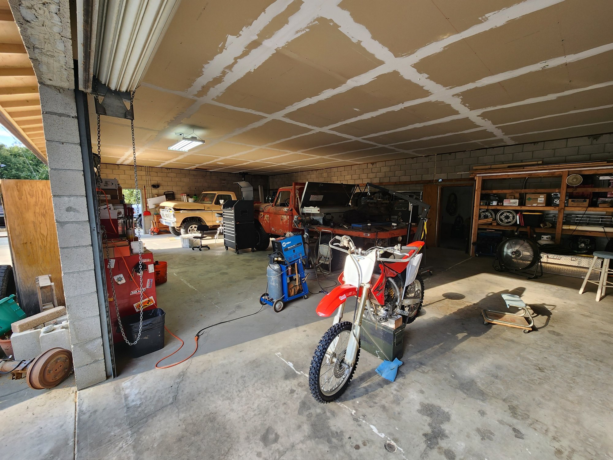

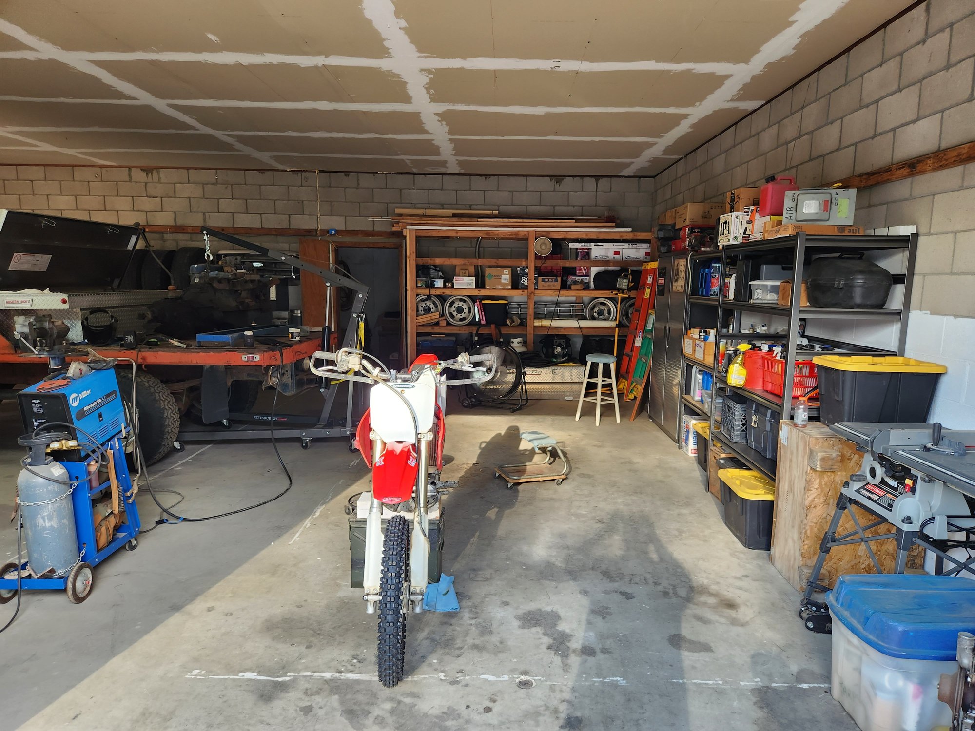

Finally got around to doing some cleaning, organizing and shelf building late July in my shop, then had Fiancé's daughters wedding in Aug. and all the fun that comes with that, as I was the caterer 🤦‍♂️ well, fiancé and I were, smoked a slew of Tri-tip and my garlic/bacon/potato dish, all went off without a hitch except for the hitchin that was supposed to happen
Lately been prepping for winter now, work and home, cutting wood, getting Sno-cat ready and loaded with essentials and putting new lights on her, hopefully this winter will be busy, but not as busy as last year when it was non-stop going everywhere.
Got "Mater" into a better position to work on, so now when I have time, I can work on him, only thing I need to do before that is drag him out front and wash him down then put him back in place.
Mr. Sid get's to stay inside, he's the pretty boy, his days of wheelin and woodcutting are few now
Organized is so much better
Made a frame for the 300 so I can move it around
Beth my smoker getting ready for work

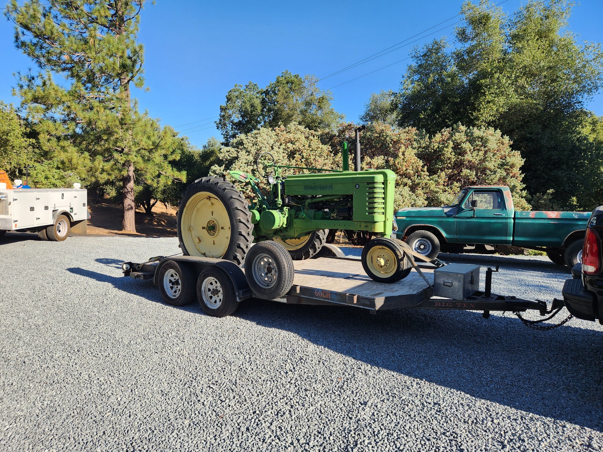

Also bought something else I didn't need 1946 Model B, it runs and drives
needs a beer holder, workin on that!

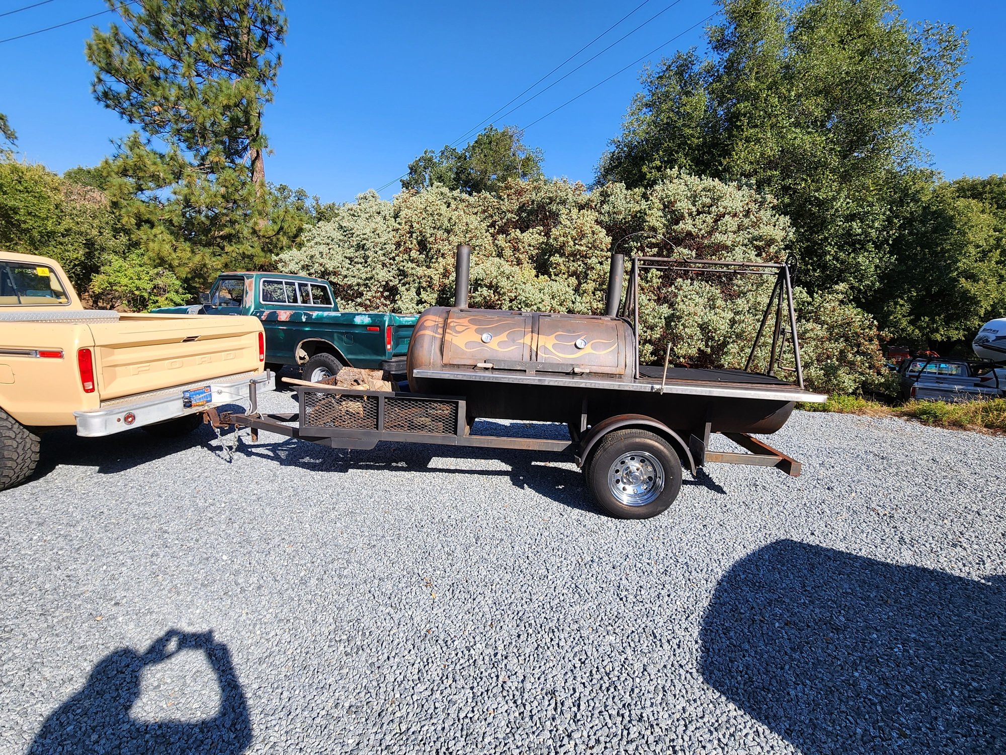

I know that we’re talking about trucks, but that smoker is sweet. The flames are a nice touch.
Old Oct 18, 2023 | 10:57 AM
  #60
Pickupmanx2's Avatar
Pickupmanx2
Joined: Jun 2006
Posts: 5,663
Likes: 985
From: Near Yosemite CA
Thanks, I wish I could take credit for it, but I bought it from a gent down in Porterville who had it made, painted in high temp stove paint, has held up well for about 15 yrs of use!
And no worries, I don't mind when threads wander
