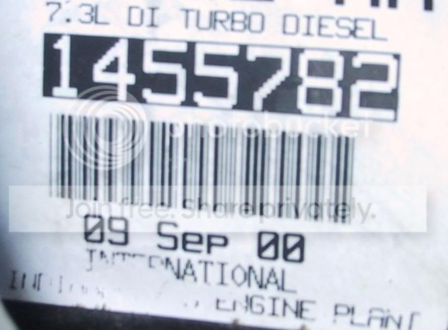

It goes back earlier than that Alan. Witness below sticker on my heartbreaker, but I got over it. PMRs are not as good as the forged but both do break. There are a lot of PMRs in high HP/TQ motors, unfortunately as Alan pointed out, ours were not made as well as they could have been. They will still take a lot of abuse though. 400 ponies is quite a bit until you get serious.

I know it was posted before but are these stickers are on the valve covers? I need to check mine.
Old Nov 26, 2006 | 01:24 AM
DavidT.'s Avatar
DavidT.
Joined: Jul 2005
Posts: 533
From: NorCal

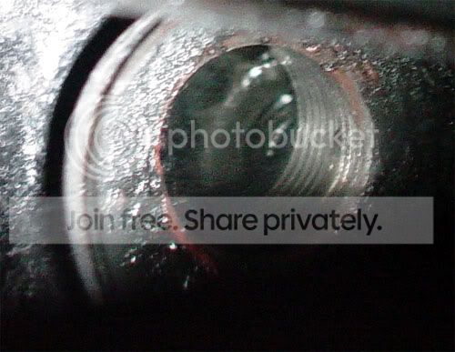

Yep, they're on the valve covers. Mine is an 01 but my motor was built July 2000.
Proof of forged rods can be proven by removing service plug on driver's side engine block near oil filer and peeping in the hole using a mirror like I did.
Here's a link for those that are curious and would like to do what I did.
http://www.dieselinnovations.com/gallery2/v/tech/inspection_hole/
