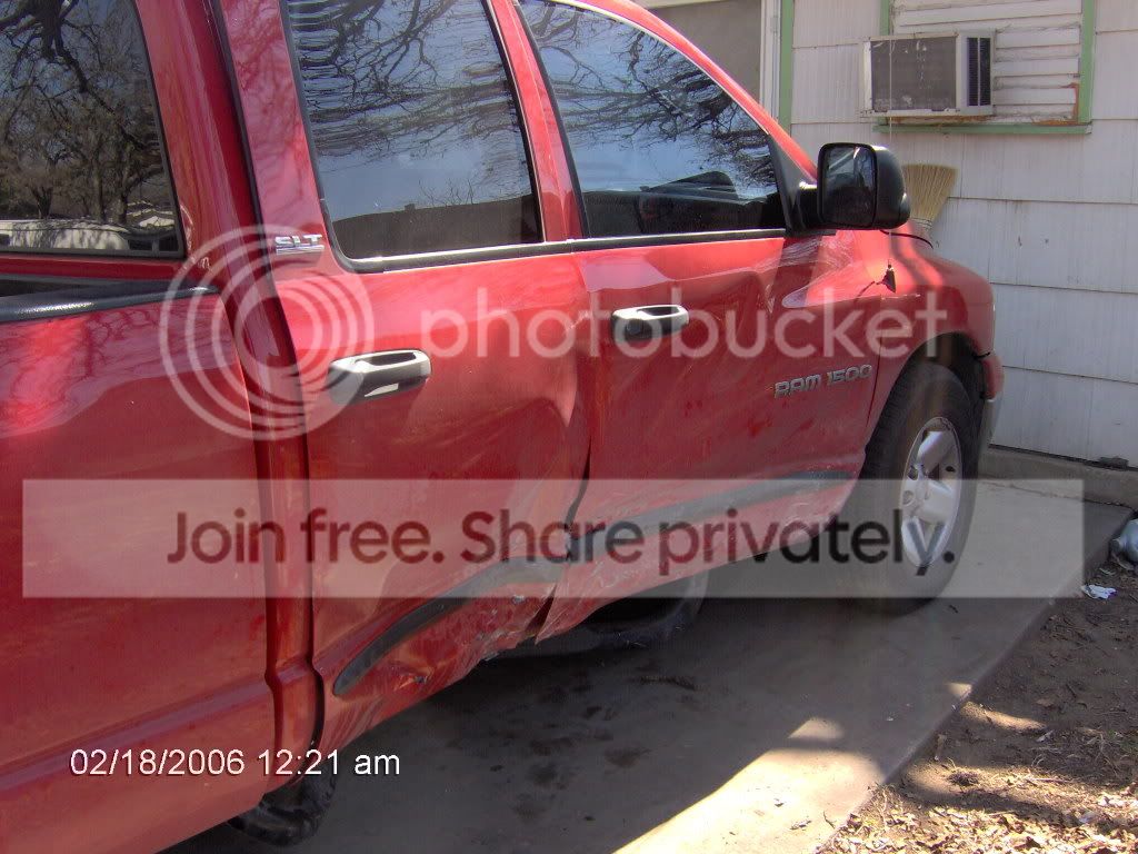

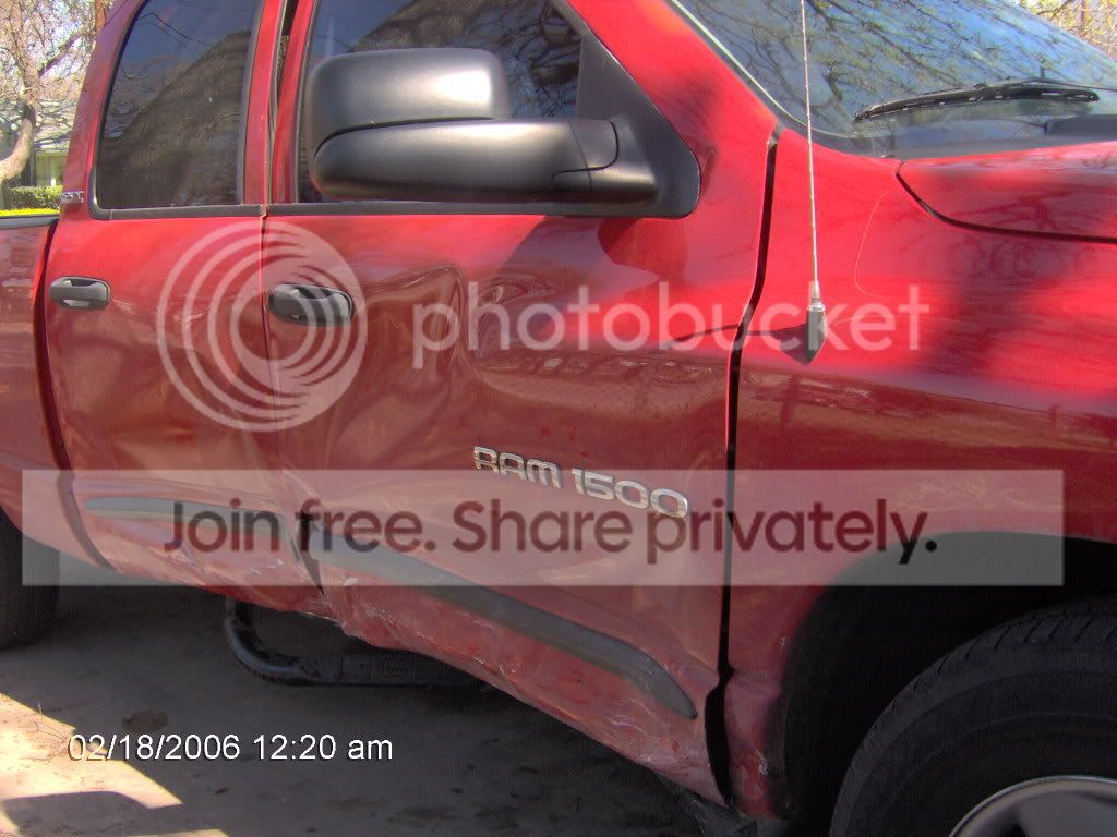

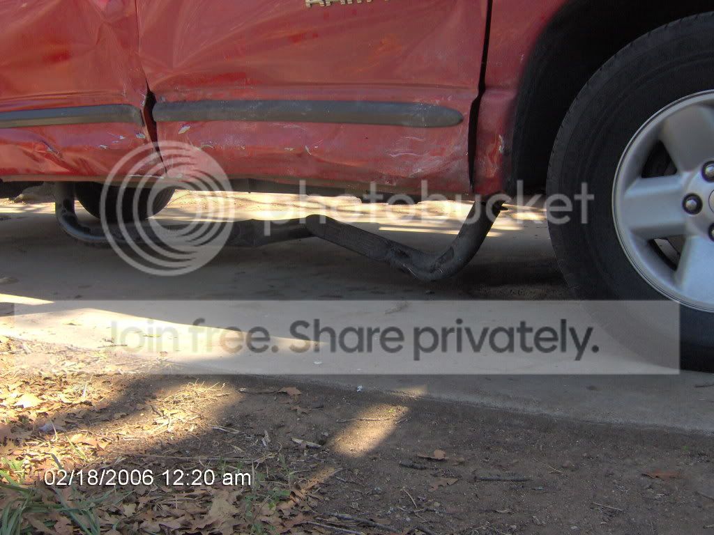

my wife wrecked our 2002 dodge ram quad cab on march 1 2006, I had had the exact same problem bro, and I just let the time pass by, and one day she called me and told methat the brake pedal had gone to the floor, she couldn stop, and crossed and intersection and got hit in the side by a Chevy caprice, (OLD POLICE CAR) thank god nobody was hurt, please pay attention to it, it could lead to a very tragic event....
Gerardo.
I bet u dont want you truck like mine...
BTW it was a total loss.
