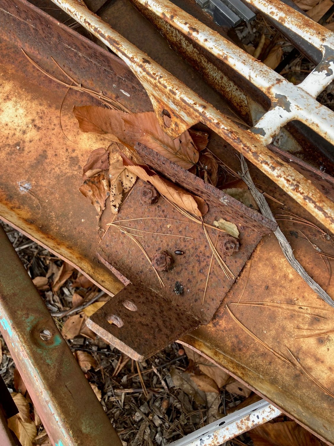

Here is a pic of the bumper I just recently got back on the truck. Mine uses to brackets to mount to the frame. The truck is a f250 4x4. Here is a pic of the brackets.
This was as I was re welding the bracket. I had to shim my core support up higher to get my body lined up, so the bumper was hitting the lower valance. I had to adjust a 1/4 inch or so to make it work right.
nice thanks for the pictures! I believe the bracket that you sent in the photo is what I am needing . Most people I talk to say all these bumpers just mount to the frame no brackets . In my case it looks like mine does need some sort of bracket

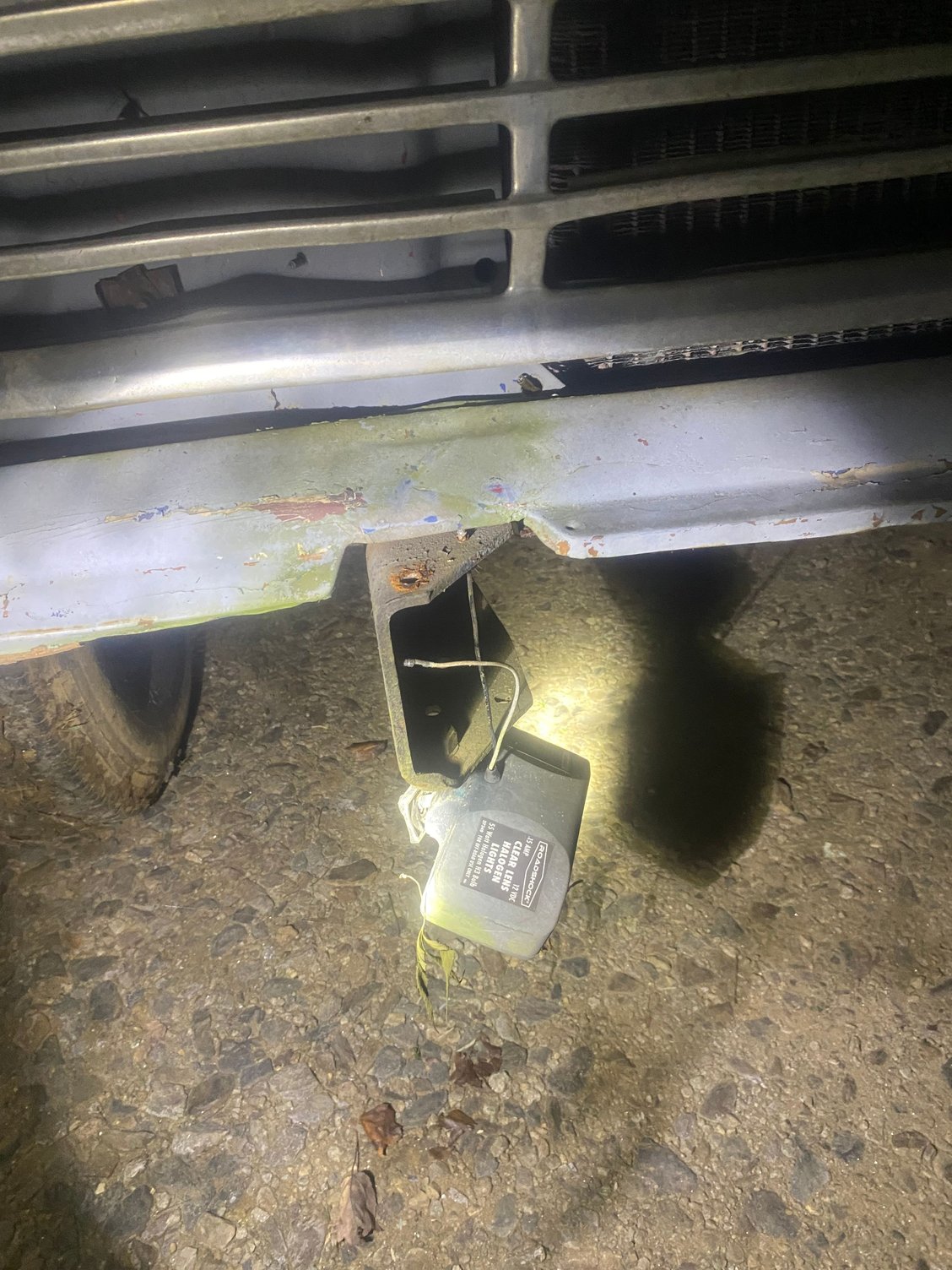

I just noticed your reply. Here is a pic of my 70 f250 2wd truck. It has the bumper bolted directly to the frame horns.
Here is a pic of my 70 f350 dually parts truck and it used the same bumper brackets as my 72 f250 4x4.

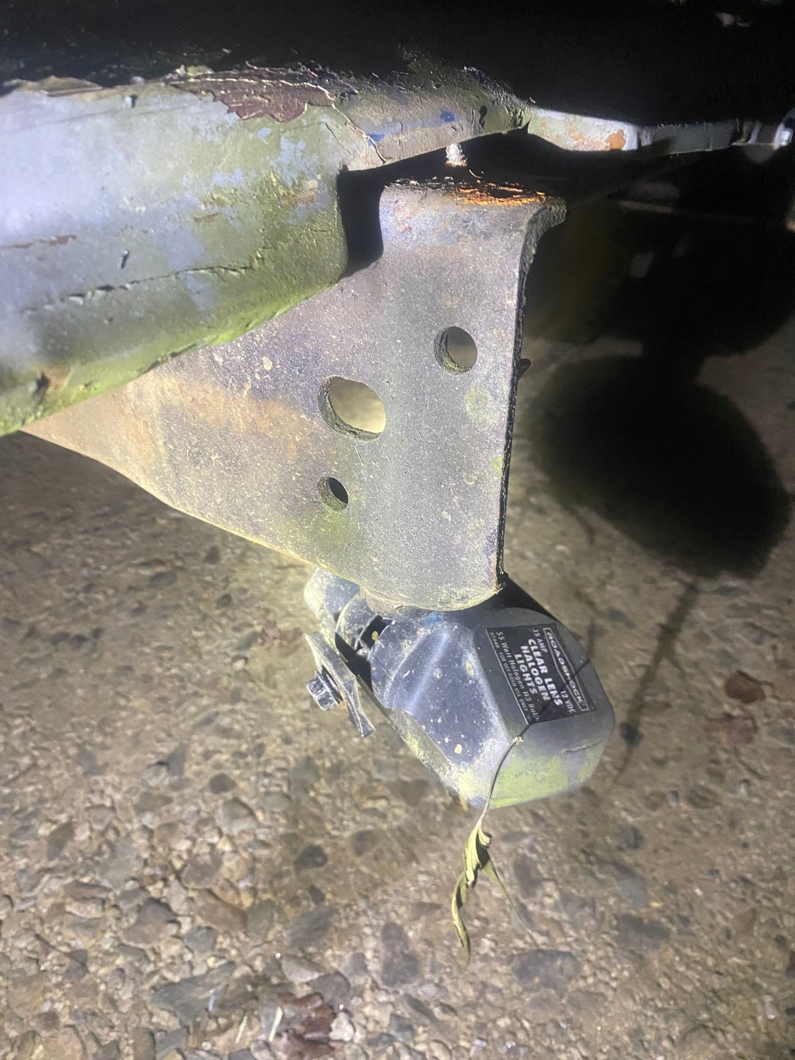

I have a pair of brackets from a parts truck
i will post PICTs later

This is one of the pair of brackets i have
